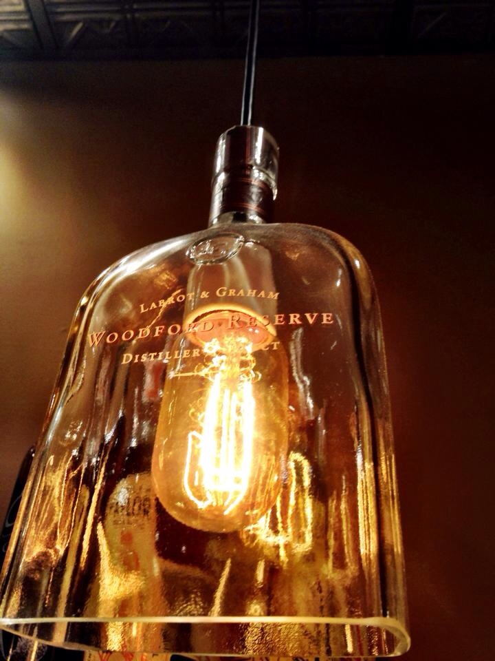

I have several Maker's and Maker's 46 bottles I'd like to use for lights/lamps out in the garage. The plan is to use Edison bulbs. I need to cut the bottom of the bottle off. I've seen a few techniques using a glass cutter and etching the bottle...heating up the seam, then cooling quickly (repeating as necessary) so the bottom portion separates. I have no idea if that actually works, but I was just planning on using my dremel and a glass cutting wheel. Anyone have any other suggestions? This is the intended result:
I actually just tried this last weekend with some wine bottles. Michael's (the craft store) has a glass bottle cutter. It's basically a jig that allows you to get a perfect circle etched around the bottle, after that you dip it in boiling water then ice water. The first one I did made a perfect cut, but the glass cracked also. The second one, no cracks, but the cut line wasn't as perfect. From what I've read it takes a bit to get the technique down, so I'd practice on some other bottles first. Also this works great for round bottles, but you would probably have to freehand the square Makers bottle.
Thanks...I wasn't really sure how well those rapid heat/cool videos actually worked. Maybe I'll try on some beer bottles first.
yes it does work. That woodford picture above is cool!
