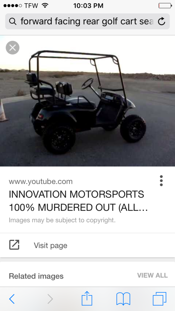

Wanting to build a front facing rear golf cart seat. I've seen some with full cages and forward seats but wanna use stock roof. Seat doesn't have to be big it's for my 2 year old daughter anyone seen one like this or have any ideas
One company I do work for has stretch carts, rear seat faces forward and rear most rear seat faces the back.. Nothing useful to add otherwise.
Don't wanna stretch looking for something like this
Looks like a good use for an extended cab Ranger or such jump seat.

you wanting to keep the rear seat under the roof?
If it doesn't matter, you could hang the rear seat off the back, and use the baggage area for their feet.
this is a good idea if you REALLY like wheelies. any significant weight behind the rear axle will pull the weight off the ground.
the "factory" rear facing seats will do it on inclines.
i run a golf cart taxi, we started out using a 4 passenger with rear facing seat. it was too dangerous. we have to go to a stretch 6 passenger to keep the front wheels on the ground.
just run wheelie bars
