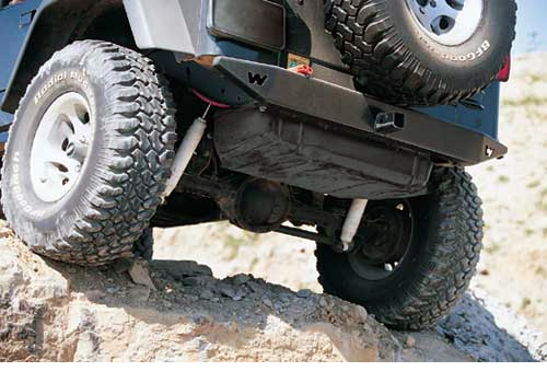

Does anybody make a rear bumper for a TJ that has an integral hitch that is actually intended to be used as such? What I have in mind looks like the Warn rear bumper:
But the Warn one specifically says it is not for towing, just carrying a hitch hauler or your bicycles or whatever.

Possible, but then you look at how they're built, and it makes sense. Neither the Barnes bumper nor the Warn have any real metal in the middle. It's not like a hitch where you have a piece of quarter wall 2x2 tube spanning between the frame rails. They're both pretty flimsy in the middle.

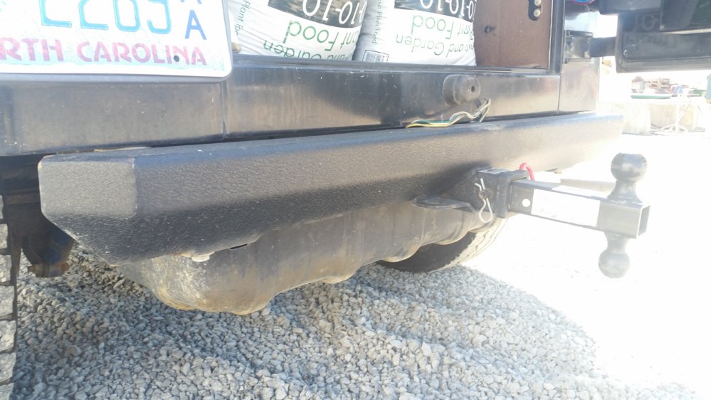

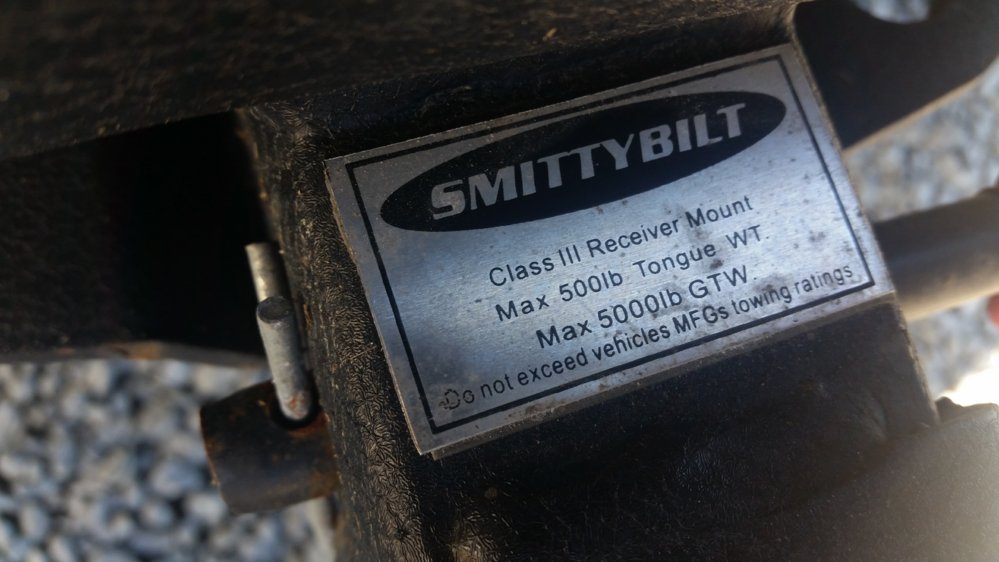

Smittybilt src classic rear bumper is tow rated, and available. Can get it with it without d-rings.
If its a fully boxed bumper, and you have the frame tie ins, you'll be fine. I think I have a spare set of frame tie-ins you can have when we meet up on the chipper. The bumper is plenty strong enough for the straight line forces of a trailer, and I assume you're not pulling a super tongue heavy trailer. A couple hundred pounds should be fine if the bumper is a fully boxed construction, so long as you don't have some stupid long hitch. Think of it like this: If the bumper is strong enough to pull a stuck jeep out with (mostly) static force like a winch or dynamic force like a tow strap, then it will be fine pulling a couple thousand pound trailer.

I had the WARN TJ bumper pictured above at one point. IIRC it specifically said for Recovery only, implying that it was strong enough for what you mentioned. I used it as a tow point numerous times with no issues. The one I had had the end bolts and also 2 center bolts that went through the rear cross member at evenly spaced intervals.
