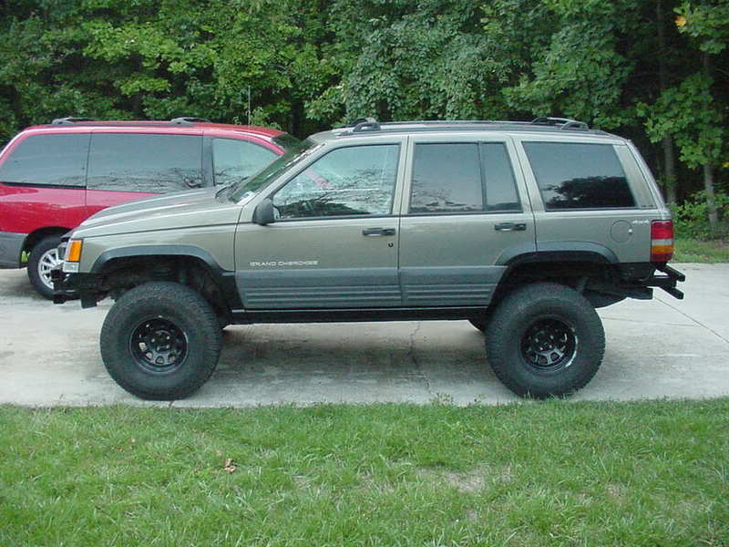

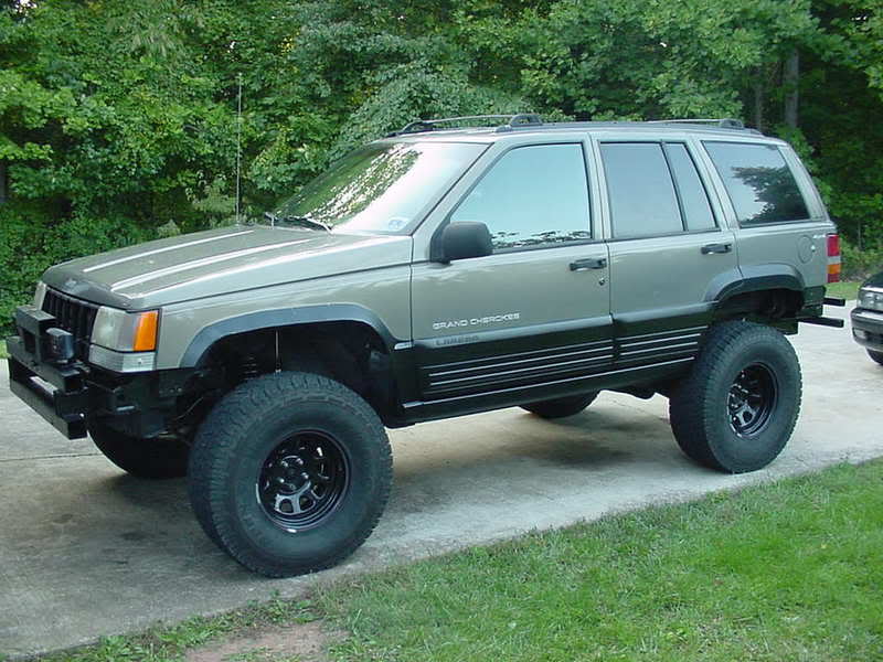

Hey guys does it look like the jeep has a 3" lift or is it more than that? The guy I bought it from said it was a 3" rusty's lift. Is there any way to tell? Thanks

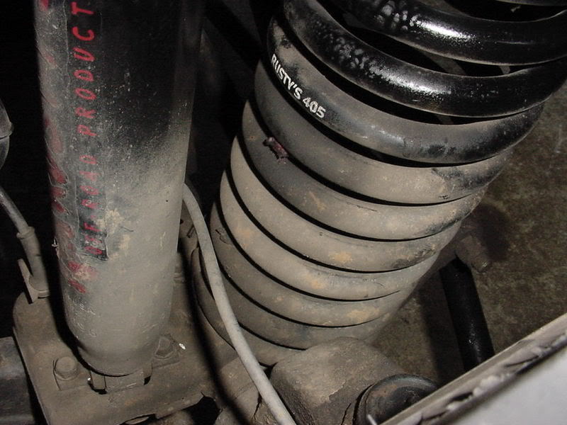

It should have Rusty's 300 in white letters in the center of the coils. I remember the ones I bought used did. I can't remember if my leafs had it, but you wouldnt care for your ZJ.

It looks taller than a 3" lift to me. Those are 33's. The fenders are hacked a bit though.

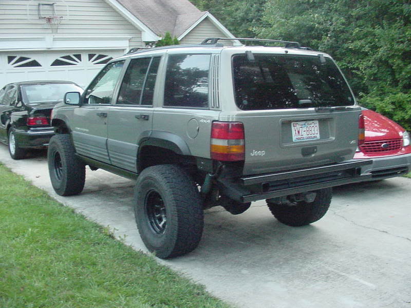

I need to move the rear axle back some.

I think the springs are 4.5" lift they say 405 on them. Is that what it means?
Also did some painting...

Thanks it's Dollar General spray paint. LOL
Anyone else know what the 405 means on the springs?

I'm guessing a Rusty's RC-CS405-XJ is the same as RC-CS405-ZJ, whichever you order you get a spring marked 405. A stock ZJ front spring is longer than a stock XJ spring, so a 4.5" lift spring for an XJ will only give 3" lift on a ZJ. Just a theory of mine, I could be way off base.
I think you are on to something here. Makes sense to me. :beer:

The v8 ZJs use a longer and stiffer spring then the XJ... hence where a 4.5" xj spring is the same as a 3" ZJ...

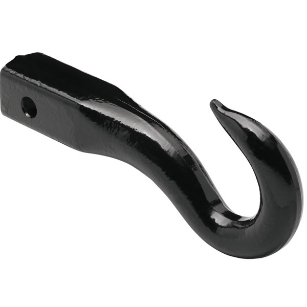

Got a big honkin' tow hook that goes in the receiver hitch. LOL
Probably build a front bumper for it soon.

RenegadeT is right. Back when I had a ZJ, I lifted it and sold my front coils to an XJ guy who added a 2" spacer to it to give his rig a 3" lift. A 3" spring for a ZJ would give 4-4.5" lift on an XJ.
