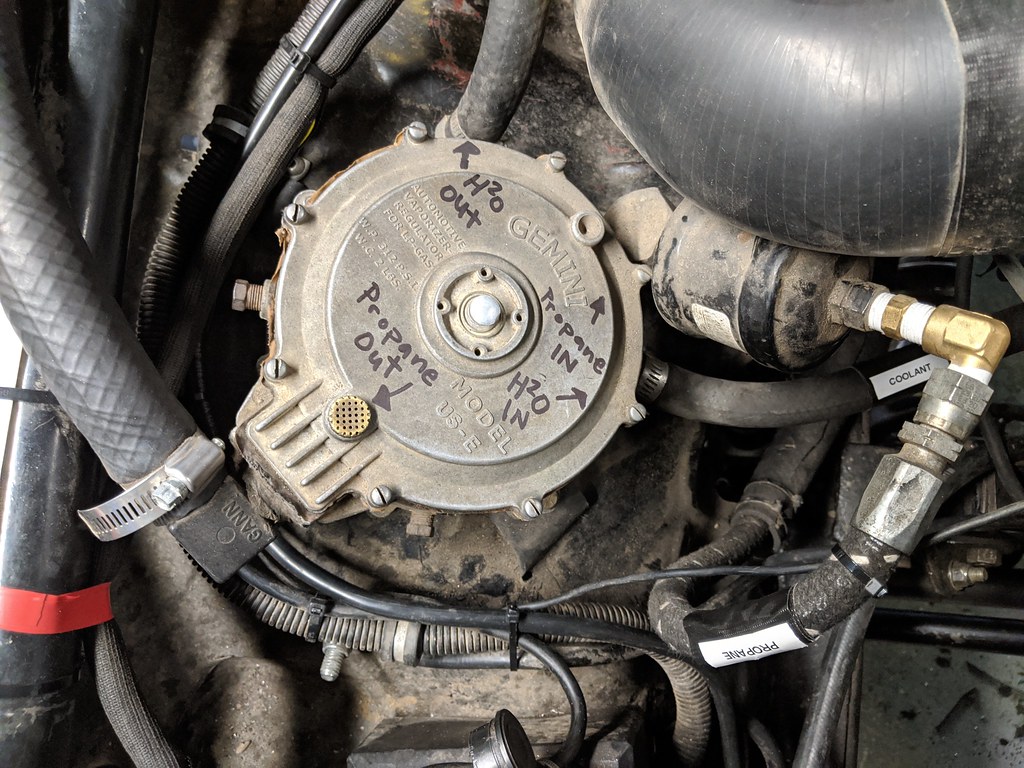

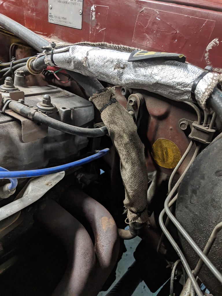

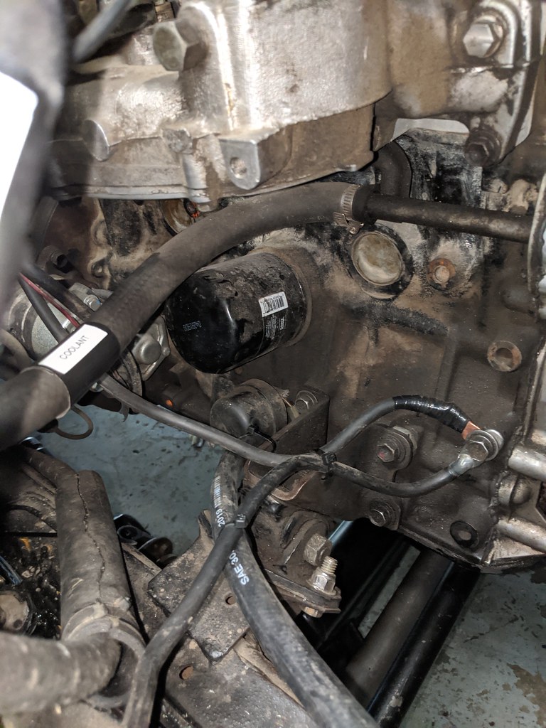

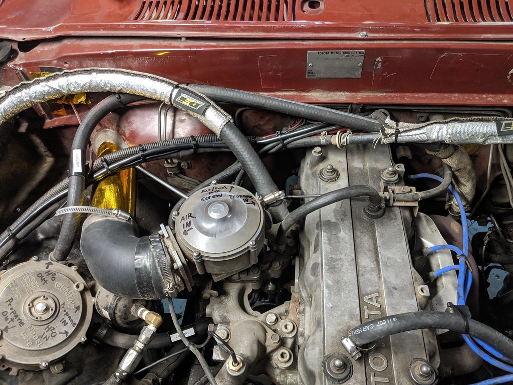

I just took these pictures for someone with similar questions. This is on a 22r manifold with no heater. I run my solenoid with a 10 amp fuse.

I ran my water lines from where the heater core goes into the firewall. Effectively I made a bypass for the heater hose while still keeping the heater core in line so that it still functioned. I got two y pipes with my kit.
