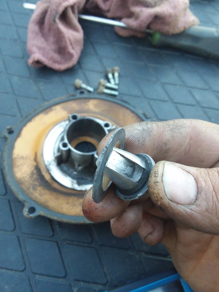

I was going to try and get a diaphragm first and throw it on to see if it was still running on the rich side before I sent it to Cary to get him to look it over and make sure it's right for the turbo and all. View attachment 262546
That looks to be a Model CA200 metering valve/diaphragm, and yeah, that’s toast. Impco AV1-12-2
Model E regulator rebuild kit is more than just one diaphragm, there are several of different shapes and action, and a filter
