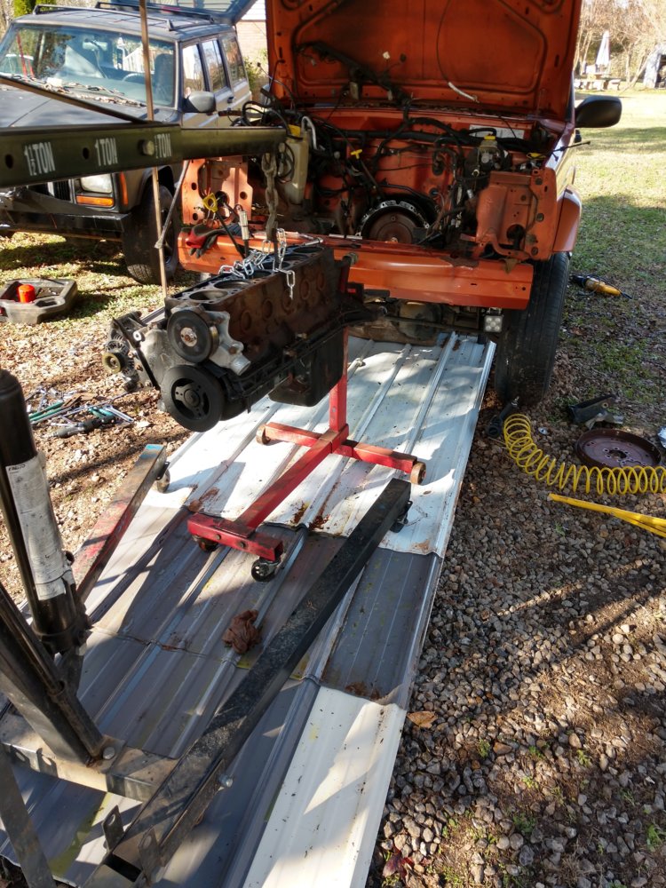

3layers of this scrap thin sheeting works well for this lol. 9 total amount. Ready for rebuild
easier to pull engine & tranny all in one piece too.
Been there but no room here.
Having that said, pulling the head first makes pulling just the motor way way easier especially for those E12 bolts
Drop xmember & you can get to them easily. Almost a straight shot with 4ft xtension. Also another trick, remove starter after removing the tc bolts and use a starter switch to bump the motor over. Match Mark last bolt to flywheel if reusing saves a few minutes. I pull the fuel rail off the intake and zip it to fire wall instead of fooling with the clips on the connectors (older model with wire clips).
