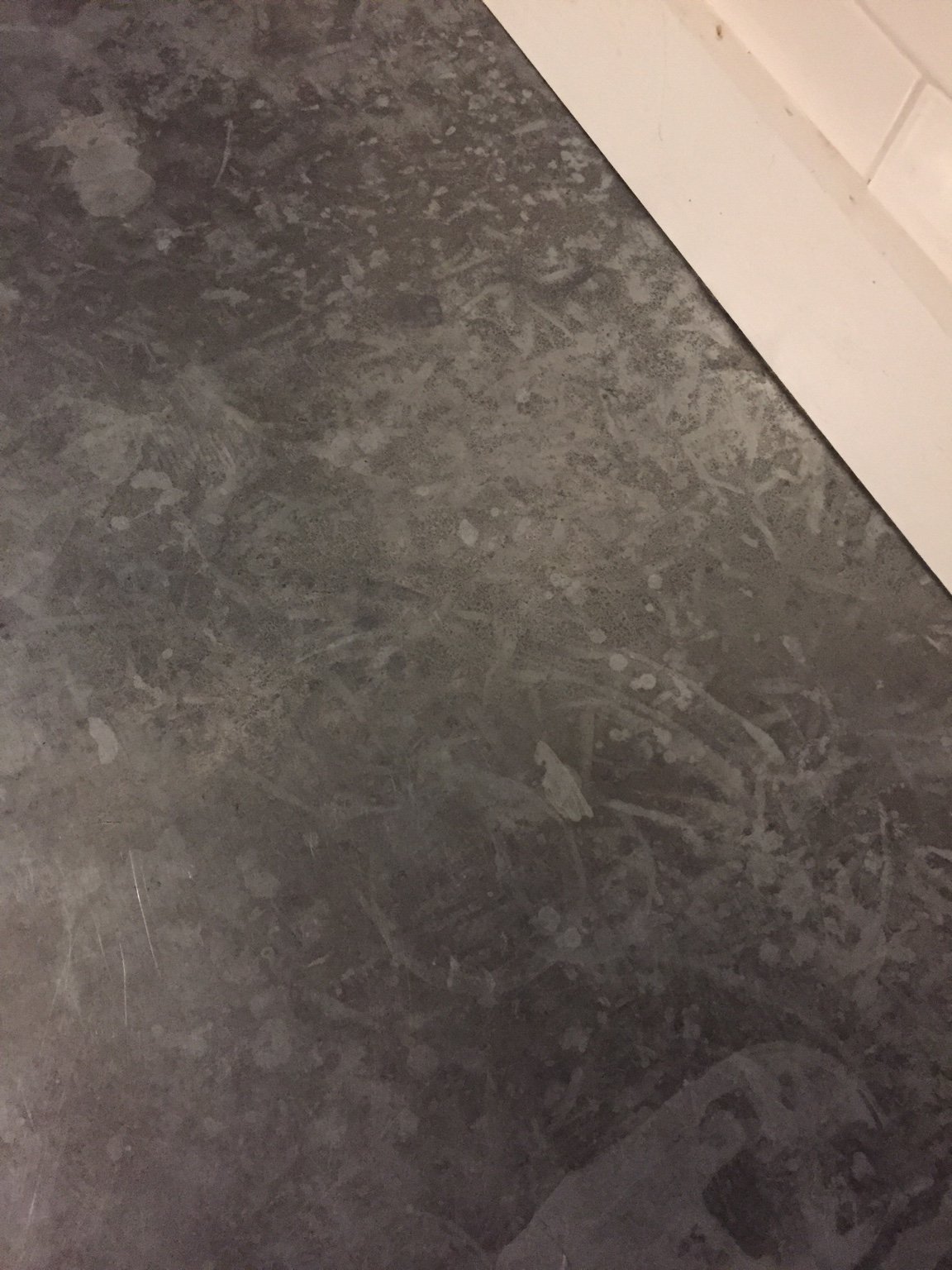

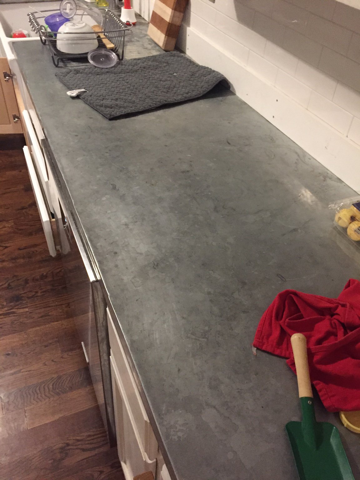

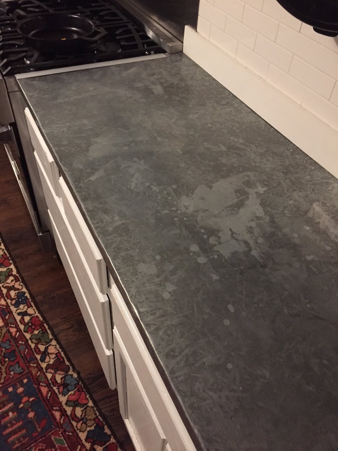

I poured concrete counters in our last house, in 06 . I used a wet look sealer I think it was poly based stuff. It lasted for many years. In our currant home I installed zinc counters. They turned out pretty good too. The finish is constantly changing as the zinc reacts with anything acidic or basic. I layered 3 sheets 1/2 plywood and broke the .032 thick zinc sheeting over the plywood. I soldered the corners. Zinc is food safe like copper. Some of y'all, with better metal skills and tooling should look into zinc. Ill likely do it again on our next house, but will have the metal broke at a machine shop to make the edges more refined.

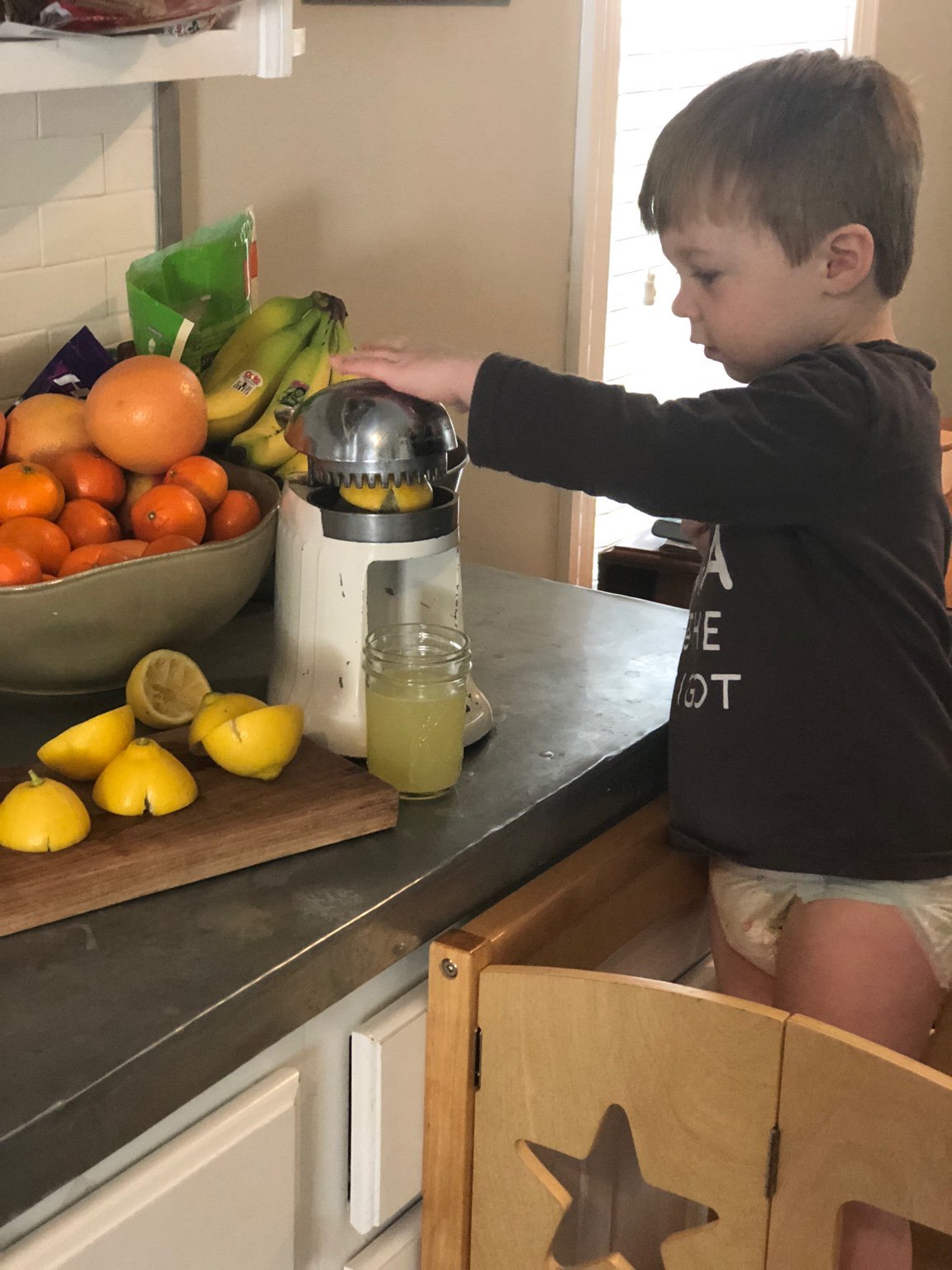

Dang it!! I knew that question would follow. Excuse the baby bottles.
In the second picture, this sheet layed outside in the grass for a few days to flatten out from being rolled up. It picked up some patterning from the blades of grass and I left it alone. I'm sure there are a bunch of "more inspirational" pictures out there in a google search. Can also see where wife and Knox made lemonade last week.
They make different etching (acid) washes that one can patina it yourself, and if you don't like the look, all it takes is a scotch pad or compound and you can have it back to a mirror finish and start over. Probably not for everyone, but if you like the funky modernish look of concrete ya might like zinc too.
Next time I will probably break the counter up about 6" on the backsplash as one piece then start the tile. This would probably work for @DSM Turbos outdoor kitchen. He'd just need to make sure the zinc wrapped under good to protect the wood underneath. It will likely oxidize outside pretty quick so a good auto wax once or twice a year would keep it nice and slick.

That sounds pretty freaking cool. I'd have to find a place to bend the sheets and all for me.
You could probably demo the concrete and build your plywood sub boxes then take them to a metal/welding shop and have them brake them around your plywood. Just have em wrap them under 6" or so. Them test fit and glue em down with a good silicone. Some hvac company's do sheetmetal brake work too.
