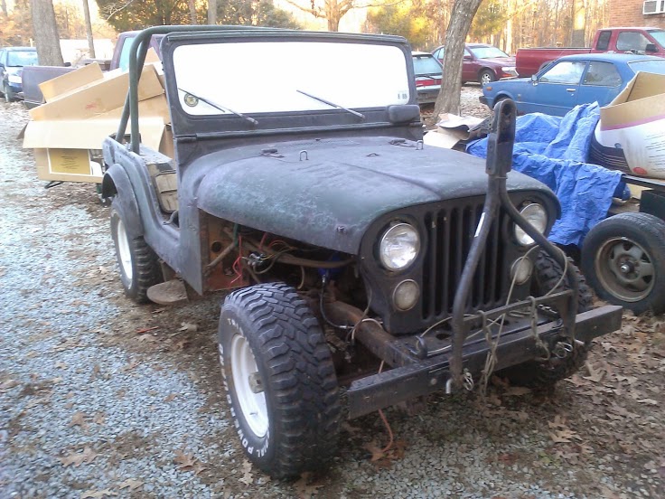

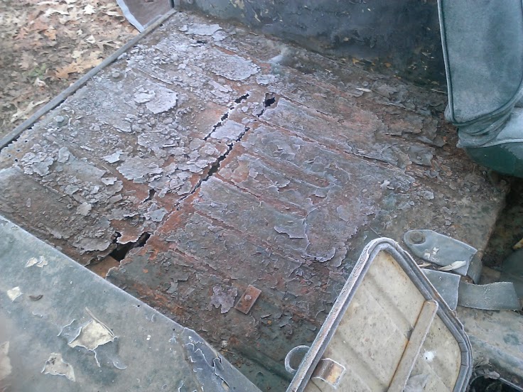

Hey Guys,
I got my 73 CJ-5 over the weekend knowing it had bad rust on the body, I thought it was going to be something I could easily cut out and repair, but its not. However I think I can get it back on the road and safe. So here is the challenge!

With a budget of exactly $1000, can I get this Jeep CJ-5 back on and off the road running safely?
I have to admit this is very ambitious of me to be trying but I'm up for the challenge. I have some advantages going my way, I own most of the tools I need, I have a welder, air compressor with assorted tools, so that will cut down on cost significantly. So first here are some pictures of what I am working with:

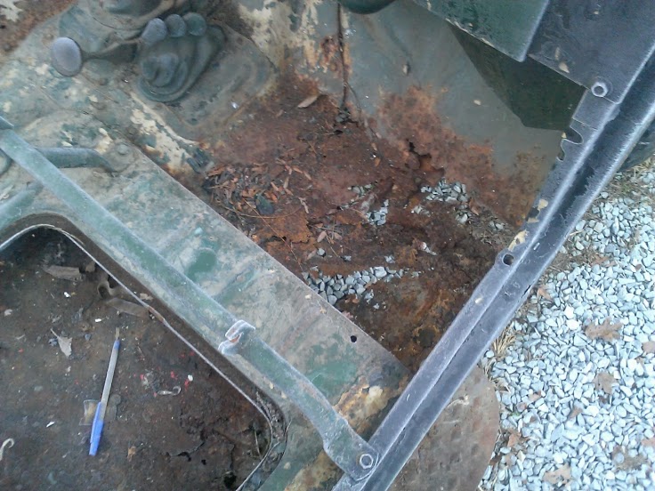

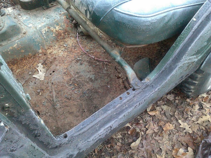

The biggest problem right now is the tub. I was going to get another CJ-5 body but I've decided I'm going to take the plug and do my best to save this one. Should be interesting!
Again starting today I'm limiting myself to $1000 to get this Jeep running safely again. This means no upgrades really, resorting to going to junkyards to find some parts, searching craigslist for deals, etc.

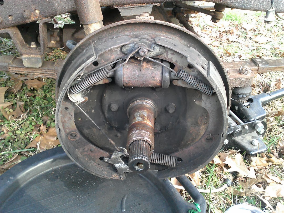

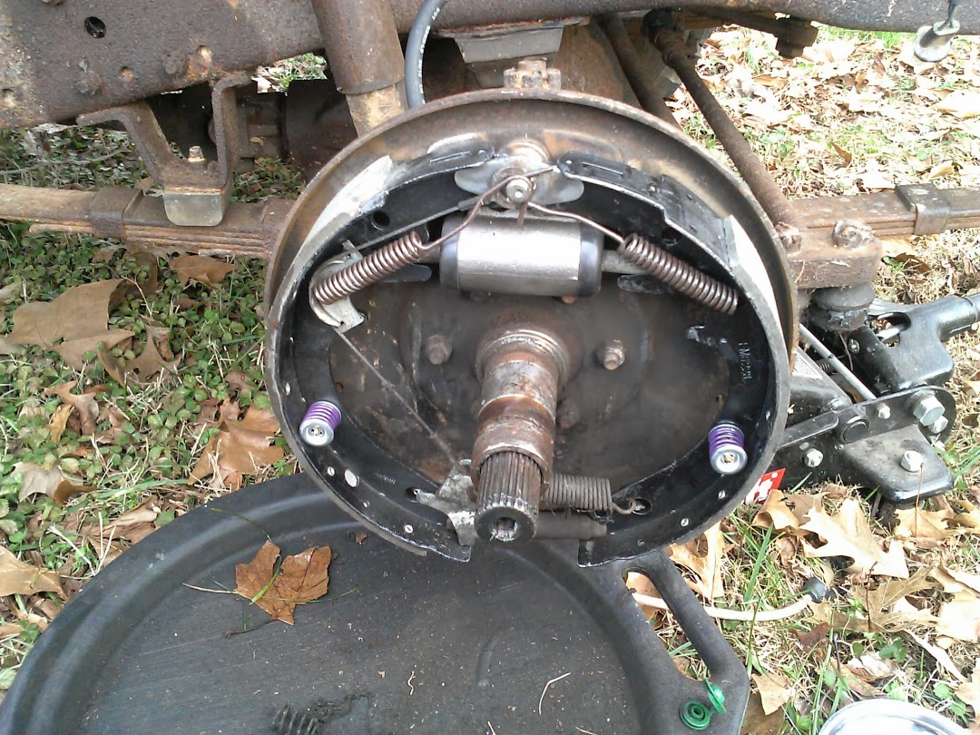

Got all the parts to do the brakes this weekend. I've got the front on and now have to take a look at the back. I made the decision to spend the money to do the brakes correctly, which set me back about $140 in my budget, I'll get the exact figures later today because I have to return some of the brakes back for core cost etc.
First off let me say I've never really done drum brakes before. Most of my vehicles have been newer or my best friend that has taught me almost everything about cars usually does the drums for me because we tag team working on our vehicles.
First off, the front took me way long than I expected, and because to me brakes are the most important part of any vehicle build, I decided to go brand new for everything, might not have needed to do that but when it comes to safety I decided it was worth it. Also I decided to something in this build which will probably blow out my budget completely but I just don't care. I'm going to be replacing every single bolt I take off the Jeep with a Stainless Steel bolt so I don't have to worry about them rusting anymore. Here is what I bought:
2x Drum Brake Hardware kits for the Front and Back
2x Drum Shoes, one set for the front and one for the rear
4x Drum Brake Wheel Cylinders
2x Brake Lines for the rear, truck came with new ones for the front
4x Stainless Steel bolts for the wheel cylinders (front only so far)
Carburetor Gasket
Carburetor Rebuilt Kit
Haynes CJ5 repair manual
Brake Parts Cleaner

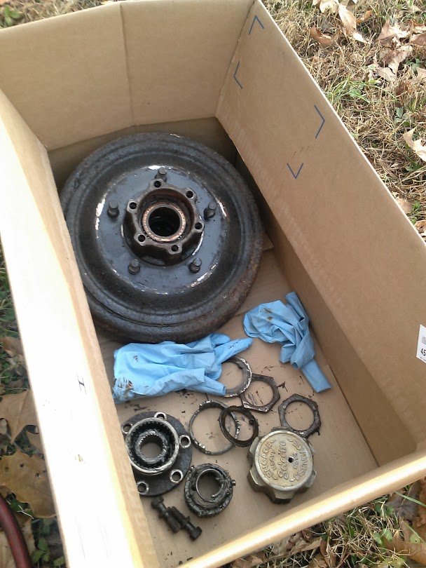

I have to admit getting the front drums tore down took way longer than I expected. I've never dealt with locking front hubs before and they were so dirty that I couldn't see all the flat head screws that keep them on locked onto the axle shaft (apologies if I'm calling the parts wrong). Next I had to deal with spindle nuts that had been beaten to crap at some point in there life. Also there was no gasket on the locking hub either and I don't have any so I will be having to get some as well. Also I need to repack all the hub, etc with new grease which I didn't have because I didn't know I would need it to get into the drum brakes. Here are some pictures before and after. The old brakes actually looked good, but I just didn't want to risk them not working so I replaced everything.

By the time I finished the other side it was dark but I'm going to have to tear back into the drums, I know I don't have them set correctly, and I have to repack everything with grease, so I will get more pictures then!

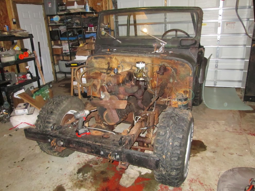

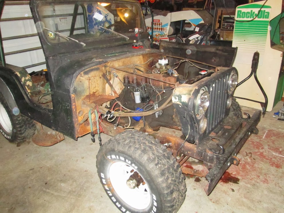

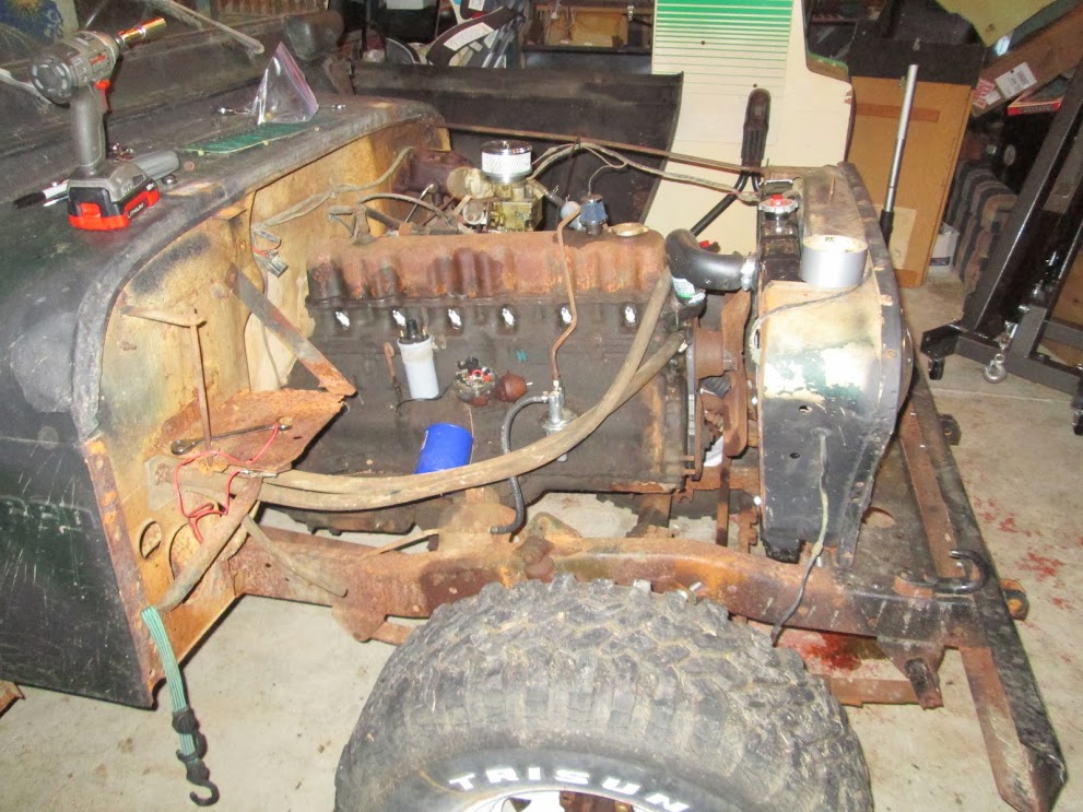

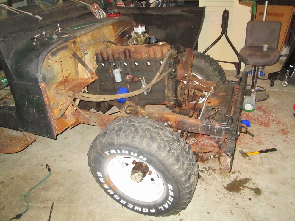

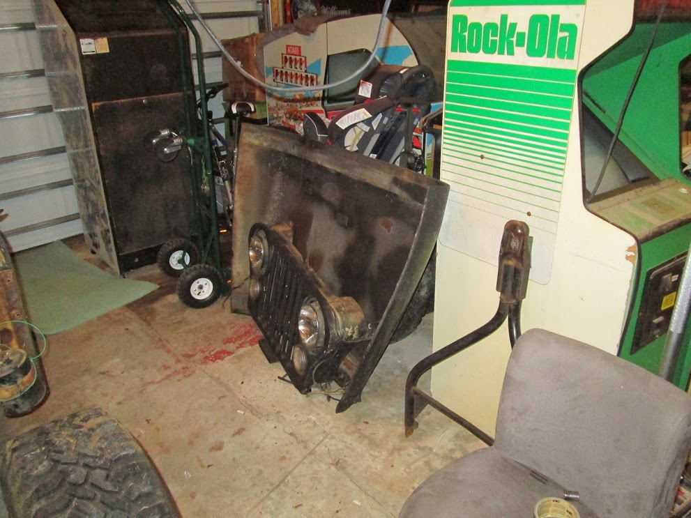

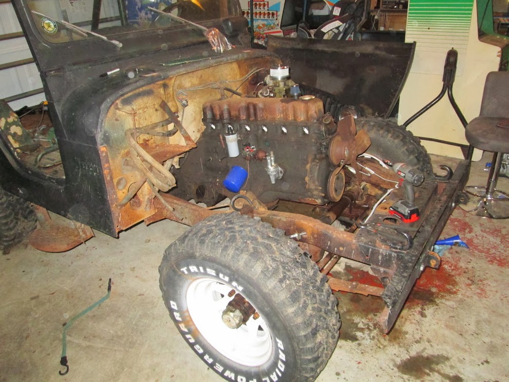

Hey Guys,
So today was a great day! Went to harbor freight got a cherry picker, picked up an engine stand yesterday, and I started tearing down the engine bay. I have to say this is the SIMPLEST vehicle I have ever worked on. I just need to pickup a chain set from advance auto parts tomorrow and I will be able to pull the engine out tomorrow! Here are some pictures of my progress!
