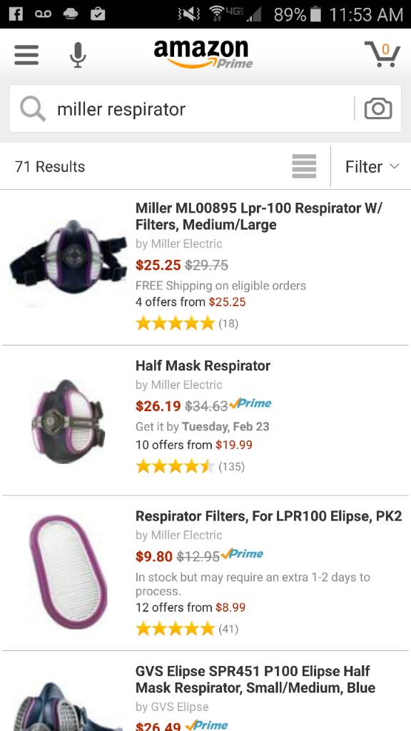

Miller lpr p 100 respirator is the best and most affordable for the quality.

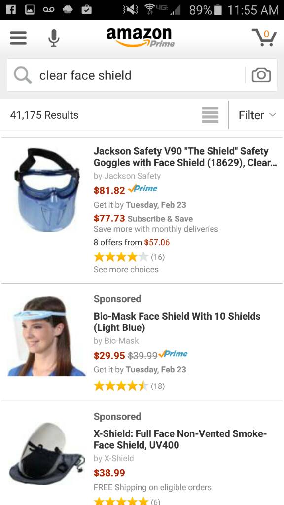

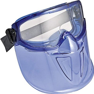

Jackson V90 looks pretty interesting
