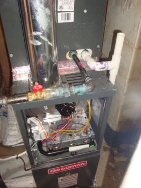

Oh, lucky me. Woke up 5 am to discover the house getting cold... the heat wasn't running.
What a way to start Christmas!
We have a standard gas furnace, can't figure this out. From what I can tell, the stat is kicking the unit on, it's doing the pre-warmup and getting air flowing into the furnace... can hear was sounds like the igniter kicking on (or at least a relay flipping) - but there's no flame. It tries a few times then quits, have to reset the unit to get it to try again.
Our box has an automatic lighter, no pilot light, and a big warning on the panel with the starting instructions, "do not attempt to manually light".
My gas meter is inside the same basement, I can see and hear that there is gas flowing for a 3 sec burst while it's trying to ignite.
So I'm baffled. Is there any safe way to test if its just a bad igniter?
Now - maybe related, maybe not - yesterday evening, we used the gas log unit in our fireplace for the first time since we've bought the house (almost a year). That thing feeds of of the same pipe line coming form the meter, not directly above but near the furnace. We're using it now to help keep the house livable :shaking:
It just seems like a really odd coincidence. is it somehow possible for there to be an interaction there?
We have a home warranty (runs out in 20 days lol), already made a service call in - but seeing as how its both Saturday and Christmas day, I figure the chances of getting a tech out here anytime soon are slim to none.

OK so i called back AHS and since we have no heat they upgraded to "emergency" and called the local company directly. Guy just left.
And, just as I suspected, the little carbon igniter coil was bad, so it just wasn't creating the spark. "Oh yeah these things die about every 2 years." Great. I'm guessing that's about a $15 part.

The ignighter is a common replacement for me, I do it at least once a year. Grainger has them for thirty bucks, it's a ten minute job. Ars also has them on their service trucks for weekend repairs.
On older gas units any rust or debris that lands on the ignighter will cause a hot spot and burn it out. Really stinks.

Yea, very common problem. That's one of those things you get a spare of and keep it with the furnace and then when it craps out, you replace with spare and get a new spare.
