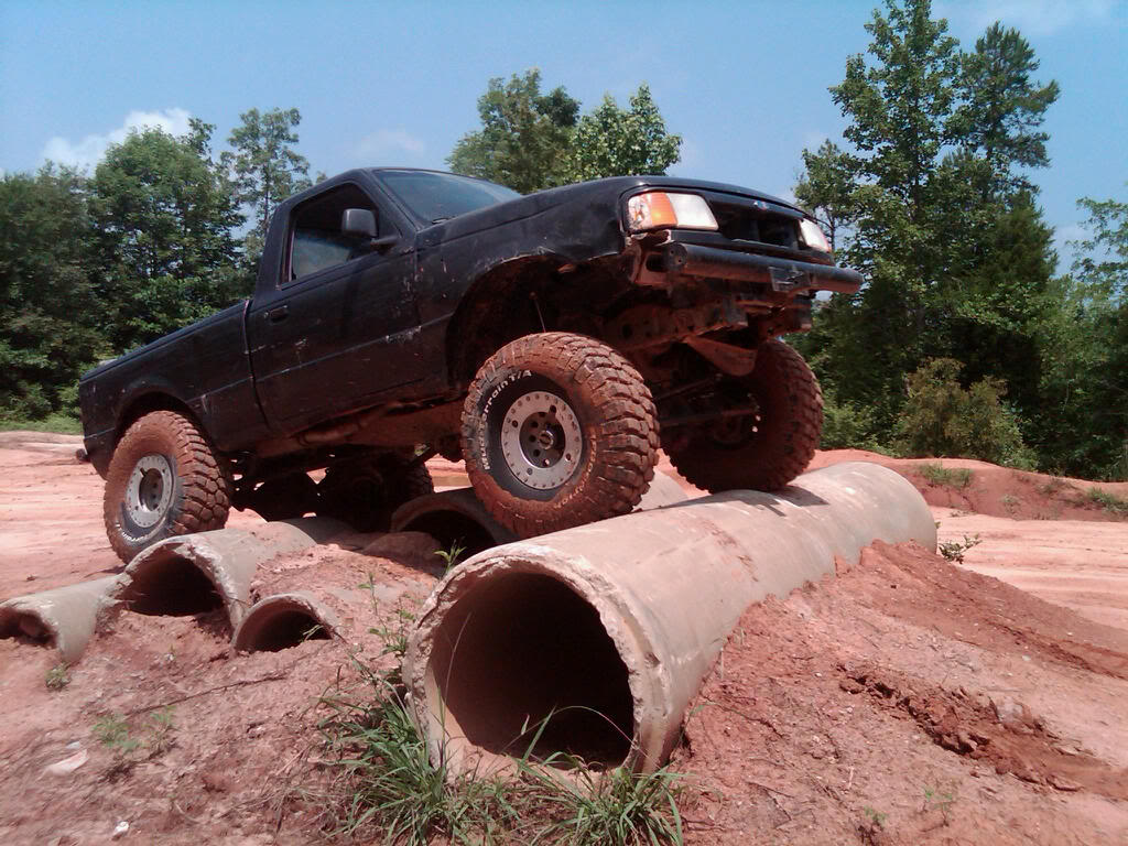

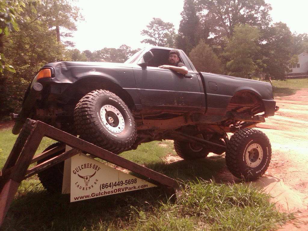

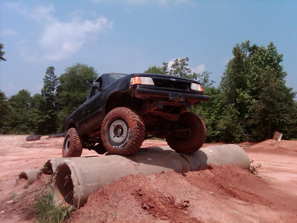

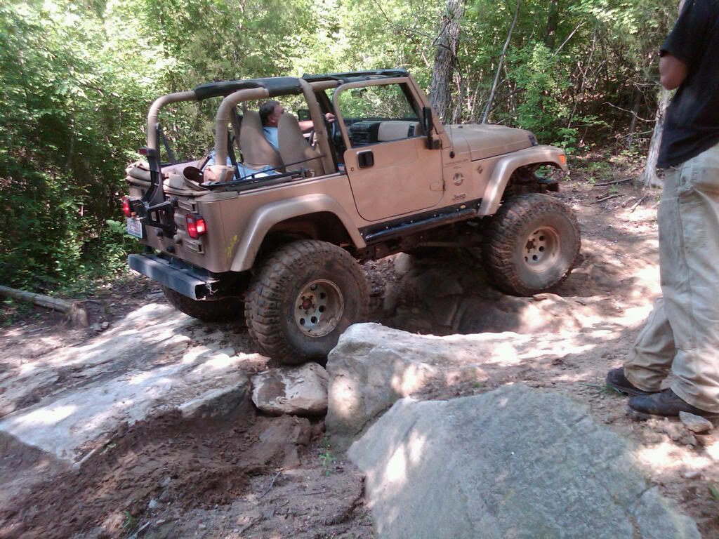

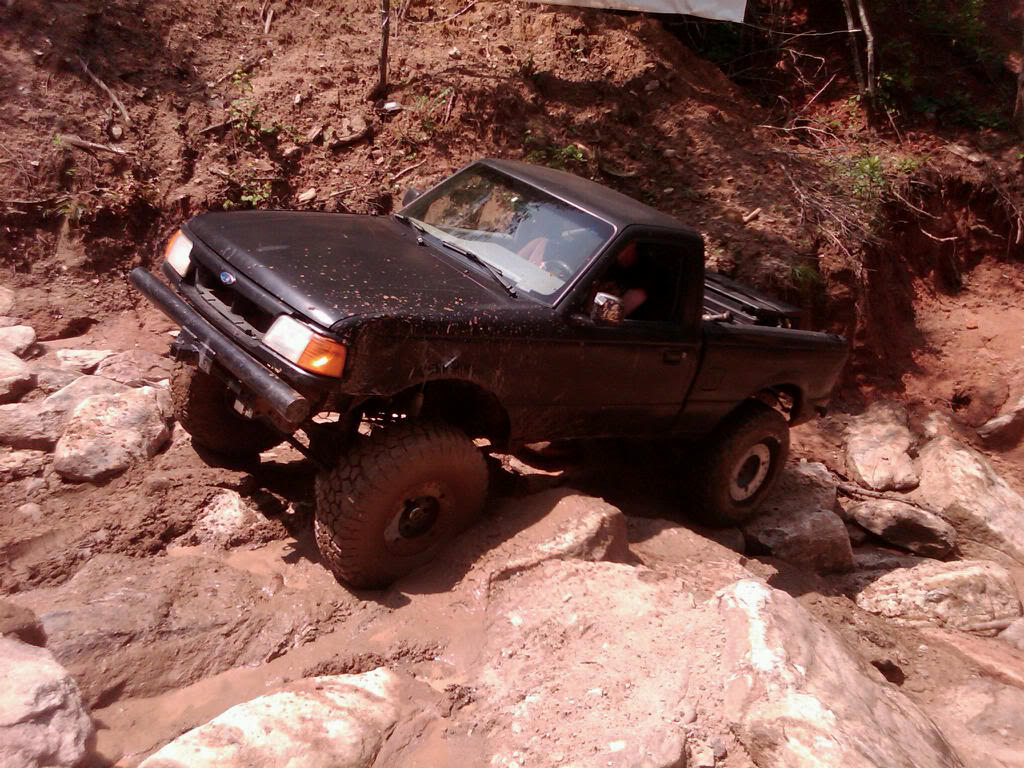

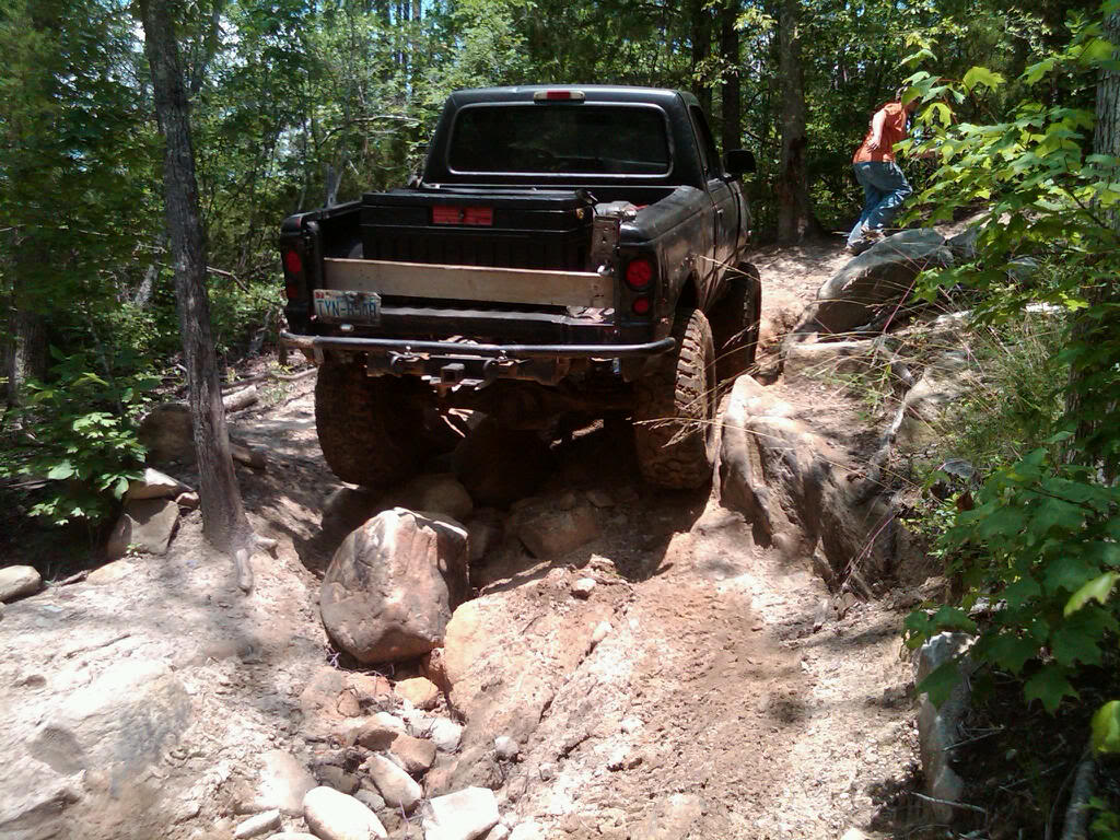

Went to the Gulches to test my buddys new SAS and rear 4 link on his Ranger. Did very very good, but need front locker, and we broke a rear axle shaft on PaPa Gulche. Here are some pictures of the Ranger and Wrangler (sparkn89's dads). and a big thanx to sparkn89 (ryan) for the best spotting job ever.
Ranger did good on the ramp. thats rear tire is off the ground.

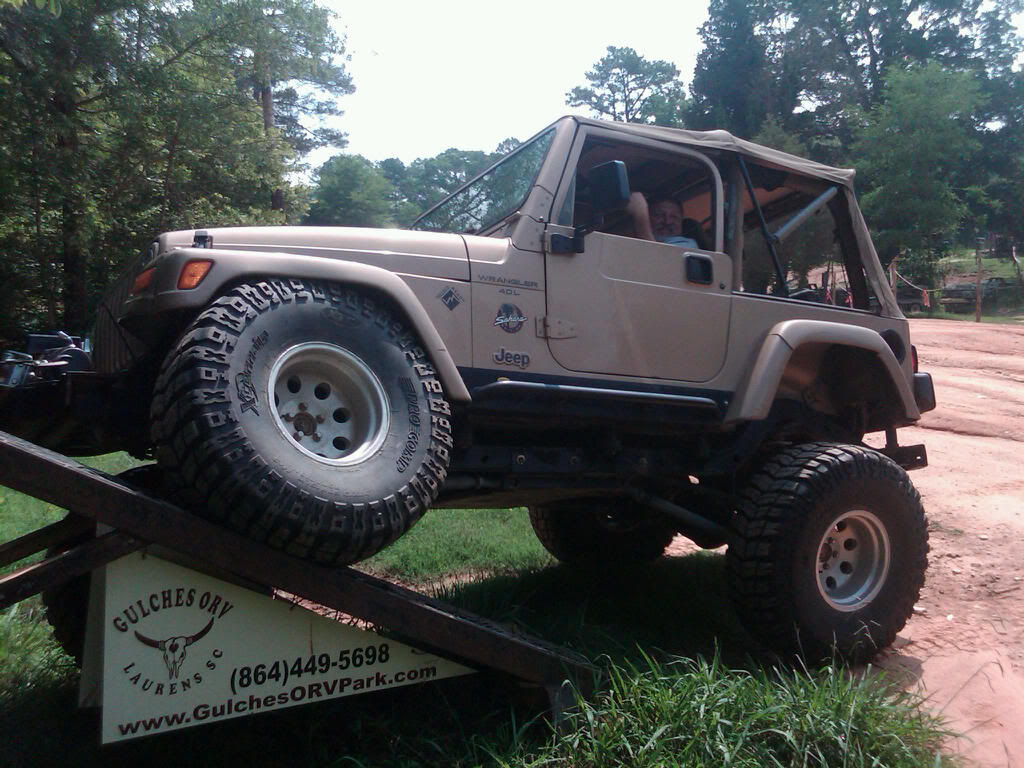

Wrangler out flexed him. tire still not off the ground

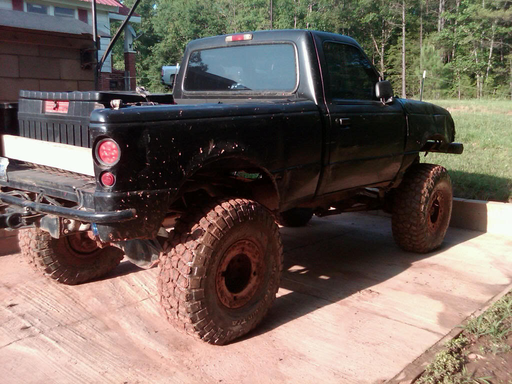

after broken axle, washing it off to waste time when everyone else still plays

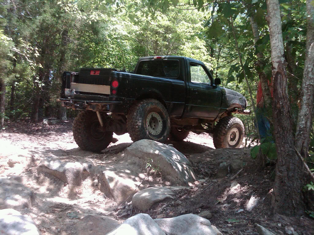

Ranger...
That Ranger looks Awesome!!!! I have a 92 I did a SAS on w/38.5s Is there a build thread anywhere? An What are the details on That Beast :popcorn:
no build thread sorry i tried to get pics but never could make it over there to take them. but its a 93 4.0L 5 speed, axles are from a '76 Bronco dana 44 front (soon to be locked), ford 9" rear with mini spool, 4.56 gears, bed is bobbed, 4 link rear with jeep springs, front is bronco trying to work more flex out of it, on BFG 35 inch tires, buying very soon roll cage, rear 31 spline axles and mini spool, front locker, some new front springs. buying in future toyota 3.4L, toyota 5 speed or toyota auto, toyota dual cases.
work great. he likes them alot. we were running them at 12 PSI. and they hooked up on the rocks great and clean the mud out very well. they worked so good he broke the rear driver side axle shaft ha ha ha
yeah i'd love to see some more pics of how he did the rear 4link. looks like he used heims or johnny joints on the radius arms up front?
yeah he used heims he got from Brad at www.barnes4wd.com . that truck worked geat it stayed with my dad's well built tj all day, it will be sweet with a ft locker. charles done a good job driveing that thing for his frist time on the rocks.
