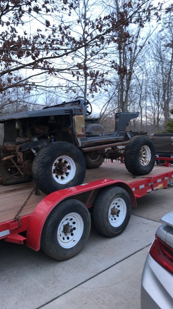

Just picked this up plan on building a trail rig for the lady someone did a Toyota swap and I’m being told it has a set of Bobby long axles in it and first question is how would I Confirm if so ? Another question is has anyone
Ran a set of rzr 1k springs on a Sami I figure I’d have to do some kind of tender spring swap but was Curious if anyone has done it before???

You planning on linking it? If so you probably could use rzr stuff but you’d be money ahead I believe picking up a set of used 14” air shocks.
If your leaving it leaf sprung just pick up some cheap shocks

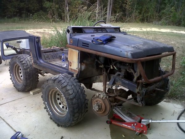

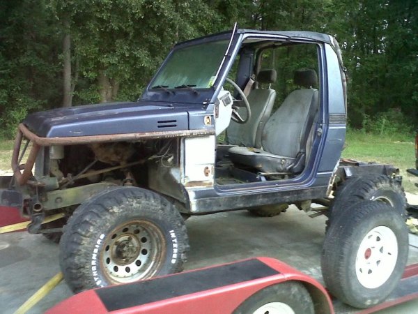

Dang that looks familiar :D
We went the air shock route. It has 10" fox 2.0s on the back, stretched to where front driveshaft fit the rear. It's about 92" now. It was a lot more fun than we ever expected.

Yes 4 link plan on running at least a 38-40 tire it has duel transfer case it needs the cob webs knocked off it.

It has sidekick power steering, but it also only has 31's and open diff. This was a collection of spare parts that became a runner for a friend to mess around with. I bought a complete sidekick for the 1.6 16v to go in mine. This one got the 5.13 rear axle, front third, power steering, and other parts I had laying around.
