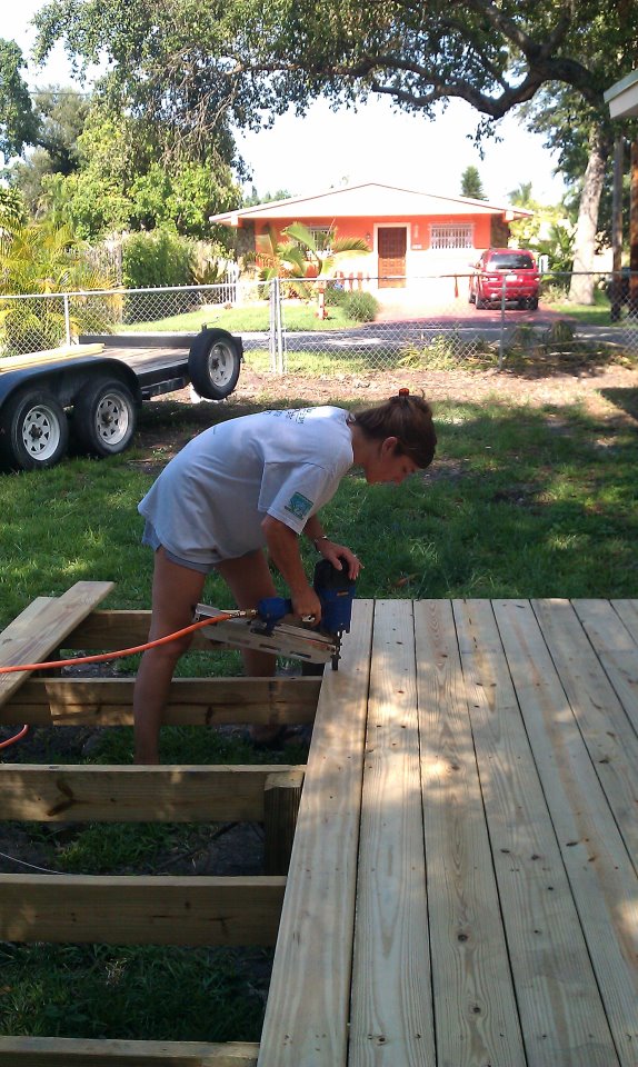

1. Purchase Nail Gun
2. Teach wife to use nail gun
3. Crack a beer and watch the magic happen!
