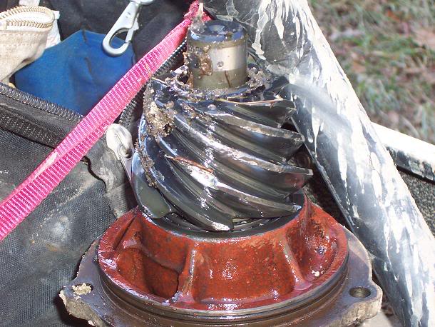

Uriah's broken 9" ring and pinion
Will broken dana 60 flange
I can *guess* that u-joint binding caused the failure of the front 60 flange, but what took out the 9" R&P?
Will had turned down his 60 flange to match his toyota driveshaft and made it to thin. He had already welded it back togther once on the trip when it broke again. Not sure on the 9" it broke just about everything the bearing caps and thrust blocker were all in pieces when we took it apart. We tried to drive his jeep home in front wheel drive when his front CV joint killed itself. We thought for sure he was going to have to pay to get it towed home when out of the blue at 11:30 at night in a gas station in middle of virgina this guy says he has a 9" third that was already setup for 31 spline shafts. Uriah was so lucky to find that we still didn't get back until 3:30am but at least we made it.
