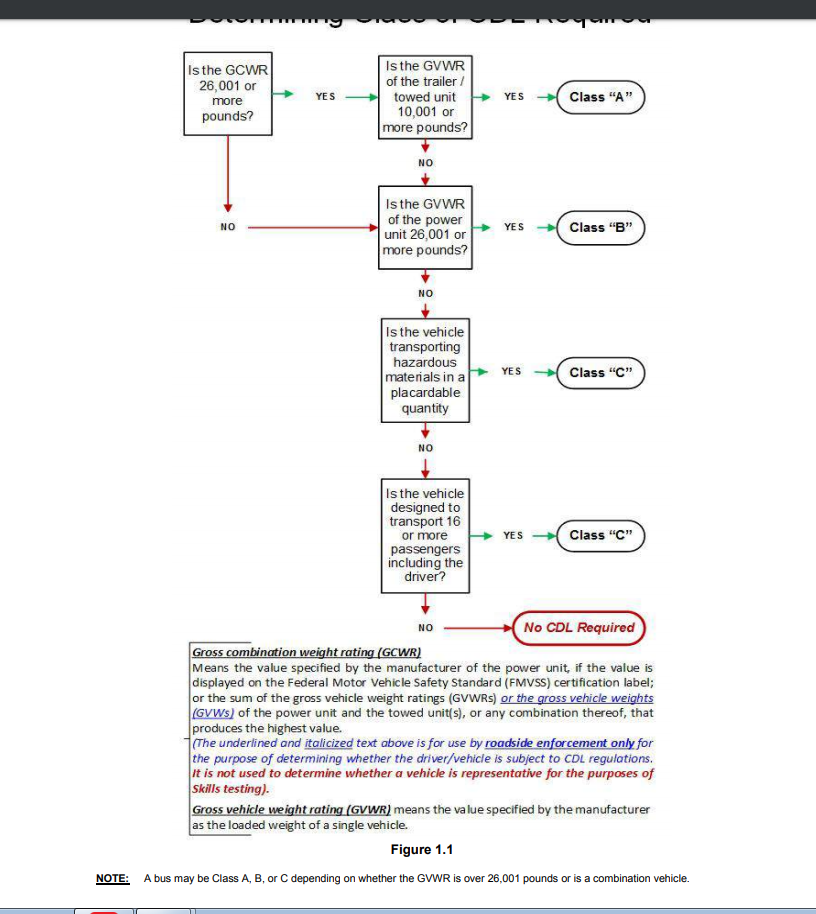

This is what the nc dmv has to say about it. Anyways, Haven't seen a "supermotors" watermark in a while. I just took the handbook test a couple weeks ago and neighbor has let me borrow a 10 spd tractor to practice with in order to take the unlimited test in statesville in a few weeks, it's not the hardest process but honestly I have always chanced it and probably still would in a setup like that--you'd be no different than any dually pulling any moderately sized trailer.

The class a license (non commercial) really has nothing to do with how much your junk weighs on a given day, it’s all to do with the stickers on the truck and trailer for the gvwr. Note the non descript “r” at the end of that. That’s the rating. So if the sticker on the truck and trailer add up to 26,000 you need the class a. There are some other aspects like the trailer part of that is 10k or more but you get the point. The camper part is bullshit I believe. Doesn’t matter if a camper or gooseneck equipment trailer etc. all the same deal for the operators license (now for tags that is not the case, there it is different for campers). My 5ver is 16k rated (never weighed it and that is irrelevant for the operators license. My truck is 14k so 16 + 14 = 30k. Bingo, need class a. When I drag @tlucier equipjent trailer it’s 14k rated, again truck is 14 so 28k. Even empty I need the class a license. When he pulls the same trailer empty with his crappy ram 2500 (j/k tommy) he is under the 26k so doesn’t need the class a. Get the idea? Of course this is all non commercial. Now your tags are a different deal altogether and need to cover the actual weight if you were out on scales. This is where the camper is unique and doesn’t count for the overall tag needed on the pickup other than pin weight or bumper weight it adds as you only have to cover the truck axles scale weight with a camper in tow. If it’s an equipment trailer u must cover entire rig weight. Confused yet? Some N.C. legislator obviously owned a camper. And an suv doesn’t need a weighted tag for anything. Again, good lobbyist or legislator had a big trailer behind the Tahoe. Not straight forward and a metric shit ton of self proclaimed experts offering advice that is squarely inaccurate. Feel free to cross check all my facts but I have spent hours sorting this to be legal and think this is accurate. There is also a Leo from Burlington on here that knows this very well and may chime in. Believe what he offers. May wish to verify with a SHP weighmaster type too if you still think this is horseshit. Hope this helps someone. For what it’s worth the class a non-cdl is stupidly easy to attain. Just a part of the cdl written and then a drive around the block with your trailer and off you go.

It is not loaded weight it is capacity. I assume you are towing it with a 1 ton or bigger. Gvwr on it is probably 10k plus. That puts you at 34k capacity and yes you need a non commercial class a.
Once you hit over 26k lbs CAPACITY you need a CDL. A non commercial Class A is only good up to 26,000lbs. 26,001 and up is CDL.
NON commercial Class A is so you can tow over 10k lbs. It does NOT let you go over 26k COMBINED.

Well...if you look in the "fees" area it shows them separately, so maybe they do still exist.
Official NCDMV: Licenses & Fees
Class A:
Description
Required to operate any combination of vehicles that:
  • Is exempt from commercial driver license requirements
  • Has a gross vehicle weight rating of 26,001 pounds or more (provided the gross vehicle weight rating of the vehicle(s) being towed is greater than 10,000 pounds)
