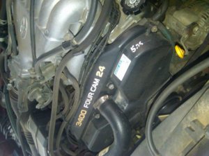

Bought a 169k 97 runner. There is writing on the cover(Pic attached) Does that look like markings that would indicate it has been done?
It runs perfect, I'm just wondering.

probably at least once, the 5.75 is the oil capacity when changing oil ( I just drop 6qts and be done with it)

and in regard to your pic, you're missing the AC belt

I too am sure it was done, at least once or you wouldn't have made it this far. You are probably about due again. I believe they are scheduled at about 90k intervals. The replacement in mine didn't last the full 90k though before the tensioner bearing gave up. I could hear it knocking but was unsure of what it was. Finally, the day I decided to look at it I drove it 30 miles home after work and when I went to start it to move it into the shade, it wouldn't start. It had jumped time when I cranked it. You will need a press to press the tensioner back in and a little allen wrench to hold it together till it's all put back together. They also make a little tool to remove the cam seals that is much easier than using a pick like I did.
'97 had a 60k interval on the original belt, '98 and on was 90k, replacement belts were also 90k, which if done on that schedule would leave it due at 150k.
