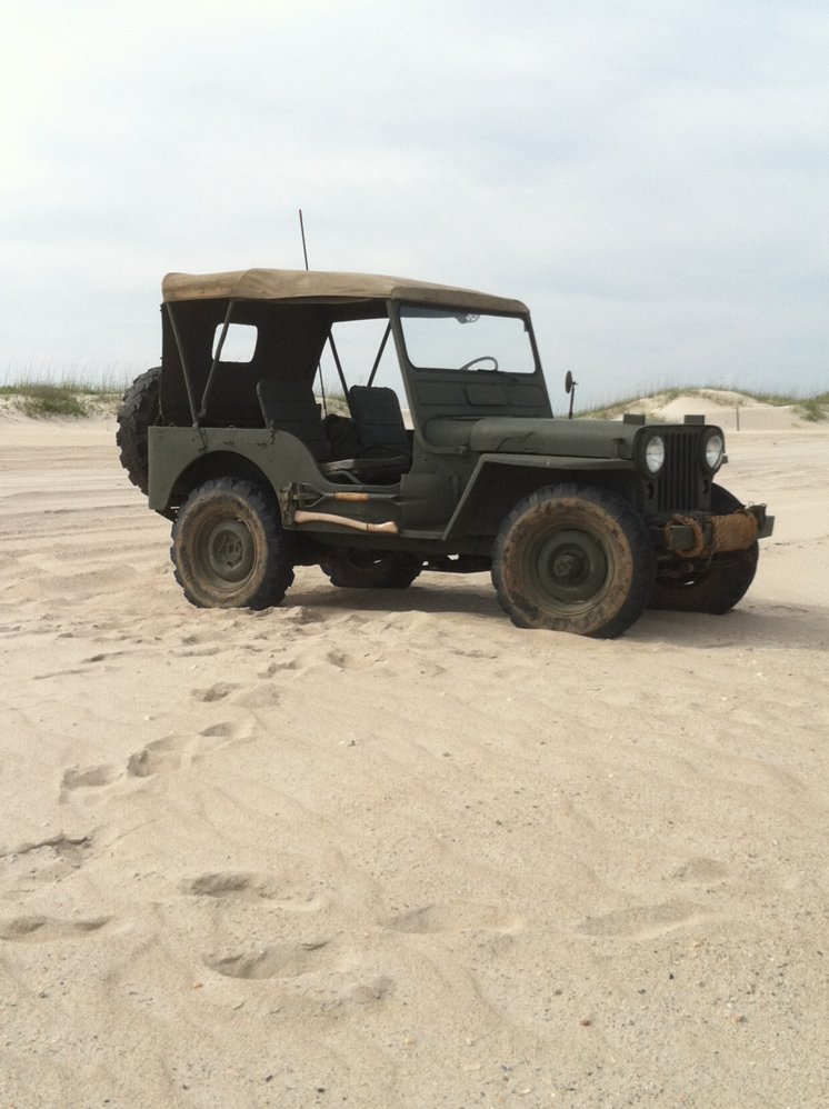

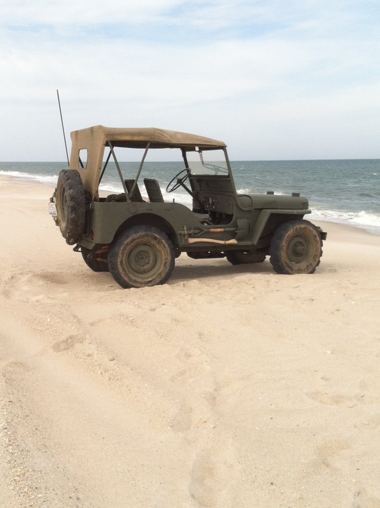

these pictures were taken at Ft.Fisher but I went out on 7.50 wide pizza cutters aires down to 15 psi. That soft sand worked the hell out of the ole gal but no stickage for us.Passed 2 full size trucks burried up to their frames and all I could do was drive around them,smile,and wave good bye.
View attachment 210291 View attachment 210292
