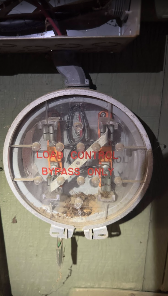

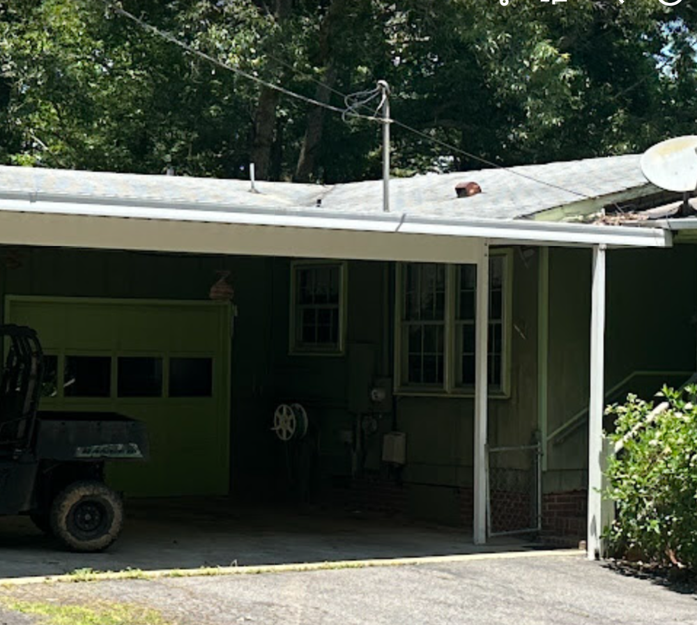

Any of yall know what this is for?
Assuming this is an outbuilding or other non dwelling?
Looks a little like a flux capacitor
Modular built in the 70s with a garage and outbuilding added on.
Best pic I can find zoomed out

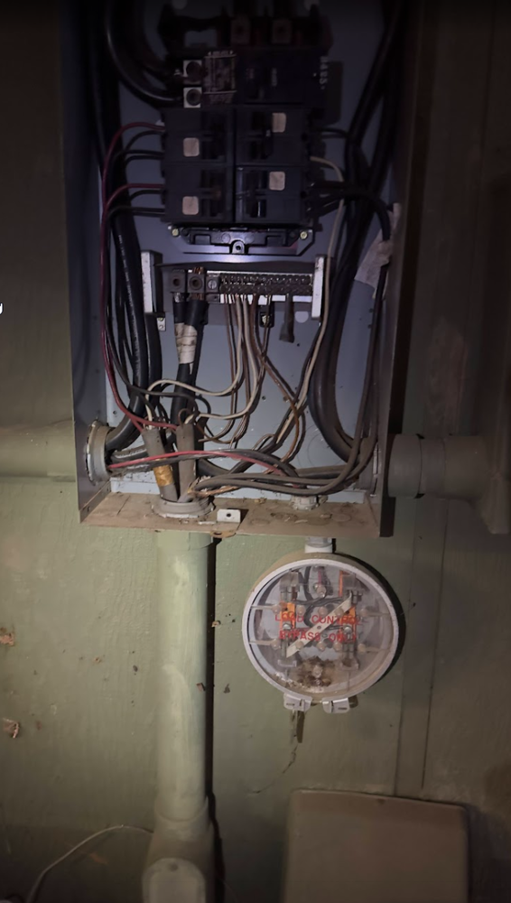

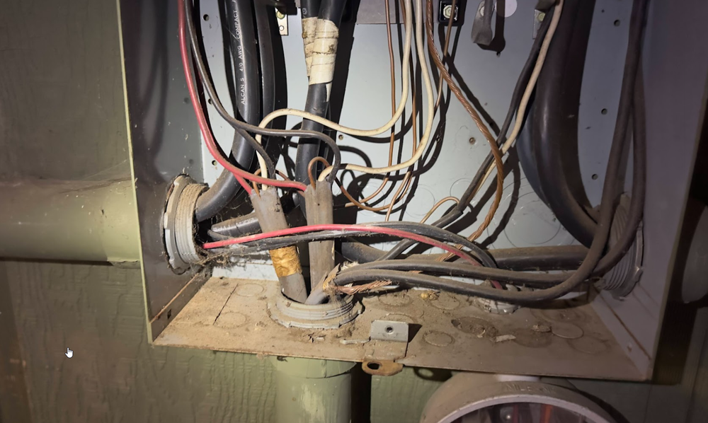

Power comes in from above, drops down to the meter, meter feeds in to the breaker panel above the mystery box. There is a ?200?amp panel in the house fed off the left side of the breaker panel pictured. The garage was added on and has a subpanel, which I believe is fed off the bottom of this breaker panel. And then the mystery box. Previous owner had a camper, and there used to be an outlet in the garage for it, so I'm wondering if this is somehow related to either a camper, or an old generator hookup or something. Regardless, I'd like to take it down. I also just noticed it is tagged, and I didn't even think to see what the tag says.
Old style abandoned - Duke load control device.
They have abandoned it and bypassed.
Duke used to have an insert that looked like a netter <meter> with no numbers and tied into a phone line and they could shed air conditioning remotely during peak demand times.
It’s serving no purpose now.
Duke used to have an insert that looked like a meter with no numbers and tied into a phone line and they could shed air conditioning remotely during peak demand times.
Thanks! I'll hit it with a sledgehammer! :D
Duke used to have an insert that looked like a netter with no numbers and tied into a phone line and they could shed air conditioning remotely during peak demand times.
Co-op had them too. There is one on my grandparents meter as well.
Don’t do that. It’s been disabled to shed but it’s still carrying something. It’s essentially a light switch that’s been locked in the on position.
If you wanna demo it call an electrician, who will talk you through it
I'm kidding, mostly. I'll do a little more tracing and figure out what is actually being fed off of it. I think it's just the receptacles in the (rotten) outbuilding.
Pretty much always a water heater or ac, looks like that one is only feeding 120 though. They don't use them anymore here but the ones still installed fail all the time.

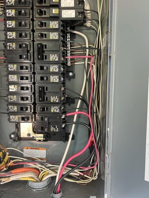

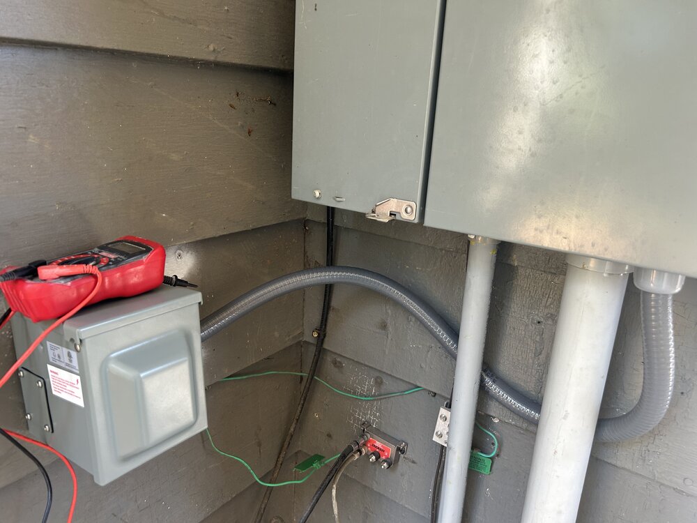

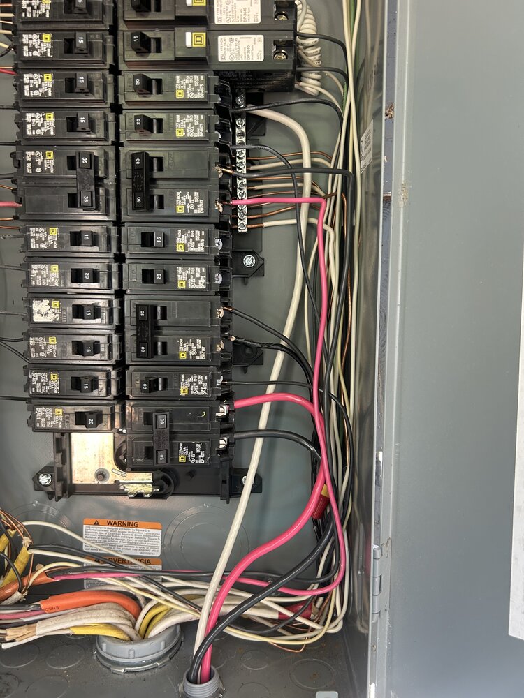

Wired up a covered 60-5r receptacle with 6 gage all copper in 3/4 conduit and a 50 amp breaker as close to the box as I could to save on wire cost.
I’m getting 143 volts between hot and ground and 298v between the 2 hots on my multimeter! Is that a problem? I was expecting 120 and 240

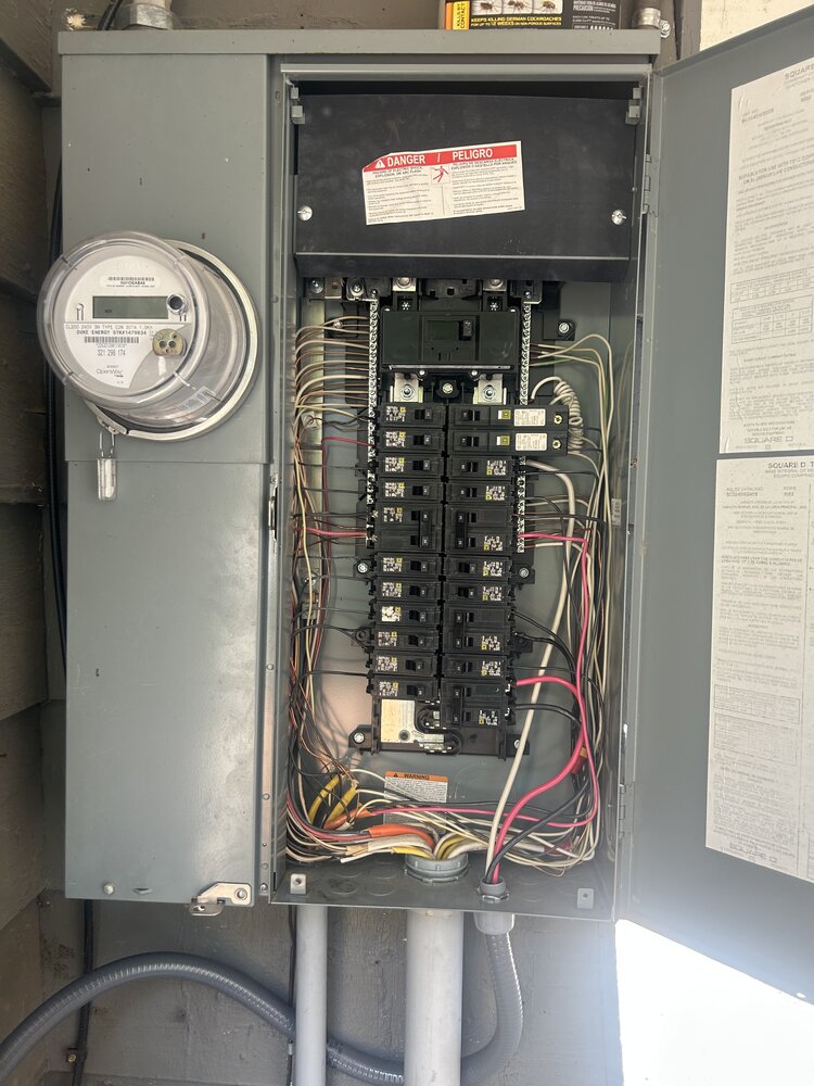

Would be helpful to see how you terminated everything in the panel and the outlet.
The outlet is wired with a bus bar built into the box so the ground is going to one of the lugs on that bar and a separate wire to the negative on the plug
It’s 142 volts at the bus bar to the ground bus as well, maybe need to call duke?
Duke replaced the meter with a wireless unit a few months ago.
It’s 143 at the home receptacles, I think duke is not transforming it down from the street
