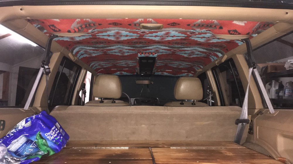

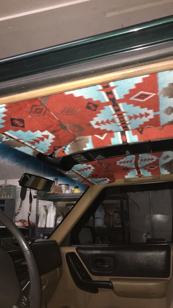

Of course everything takes longer then anticipated but it’s finally done and I couldn’t be happier with it. Some people are gonna like it and others will hate it, either way I could care less. I like different and this is certainly out of the ordinary.
