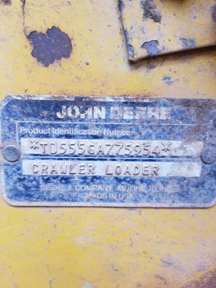

I have a John deere 555G coming over tomorrow after work. Has a busted cyl lug on the bucket. That's easy.
Not turning right, it's a struggle. I need a steering adjustment procedure if anybody has one for this unit.
Serial number? Lever or pedal steer? first thing to check is clutch pressures on trans control valve
Pedal steer. Right pedal is about 1.5" higher.
The owner said he tried to adjust and made it worse.
What pressures should I see and where is the valve located?
