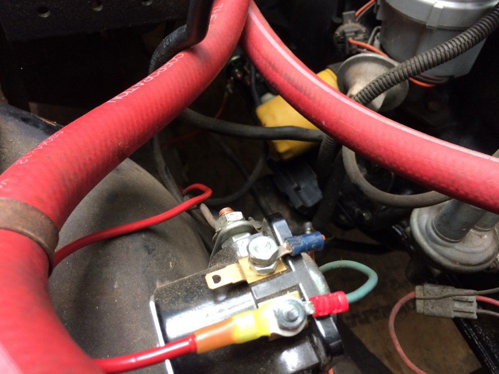

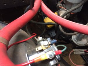

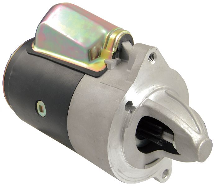

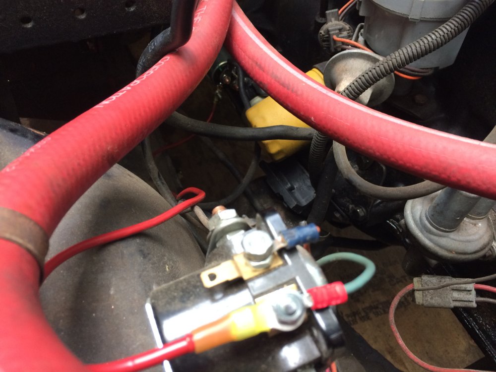

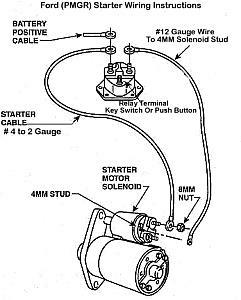

Took the starter to the parts store to run it on the stand. Turns out with my little jumper wired up, it lingers a little while the bendix is extended.
Sooo I need to find a solution. The problem with the OE CJ starter was the bendix stuck out beyond the starter case. On the '91+ starter the bendix is recessed but it's GM style with the solenoid on the case, hence why I made the jumper.
The attached pic is the '91+ starter, I didn't take a pic of my old starter but google has a decent one:
Got the starter figured out. Hooked the small post on the starter to the "I" post on the solenoid and it works flawlessly.

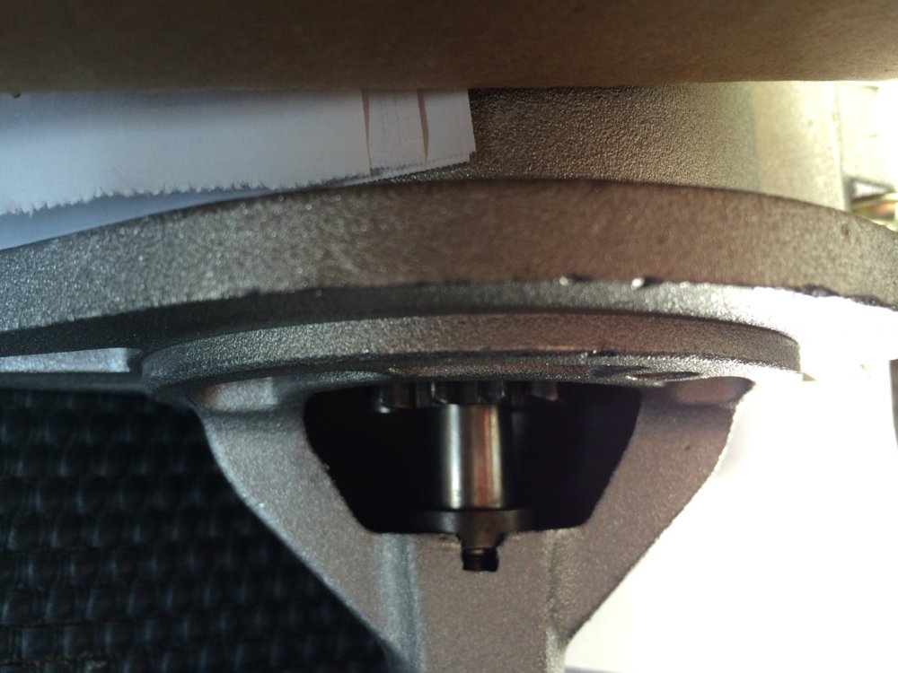

Now for the knock...
