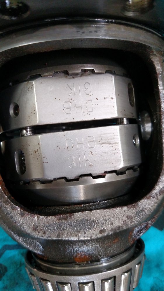

Help identify locker brand
Loganwayne
#BTL
Feb 15, 2013
Clyde, North Carolina
Its out of a Dana 30 lockright style locker this was on one side of the locker
Definitely a Richmond (now Powertrax) Lock Right. See pictures in this thread: There is an etching on the locker parts with the Richmond logo and "DHB" on the same part.
http://www.virtualjeepclub.com/showthread.php?52134-Dana-30-lockright-install
The pictures are the same as the locker I had in my old axles. But they are still different from this one, nothing on the other side or anywhere else I can see right now. Probably gonna pull it all the way out and do some more digging tomorrow. It could be an older model or newer and they changed what they etched on the inside to
My point here is that the same "DHB" letter combo is etched into yours and in that Richmond-logo'd part in that thread. That's a pretty strong correlation. If it was another brand it surely would say something else. In my Google image searching all the PowerTrax/Richmond ones had markings on the sides, none of the other brands did.
I guess when I pull it the pins should tell me pretty well what it is since fro. what I can tell they all have different pins and springs set ups. Stupid in my opinion but probably how they are were able to use pretty much the same design
Have you tried calling Powertrax yet?
Yep I got a part number for it. They don't sell direct is what the tech guy told me. Only place I found it was on summit and it was 50 plus shipping. No pic on there so I couldn't check to see if it looked right but that seems really high for that part. If I buy it there and a new cross pin I'm half way to a new locker
