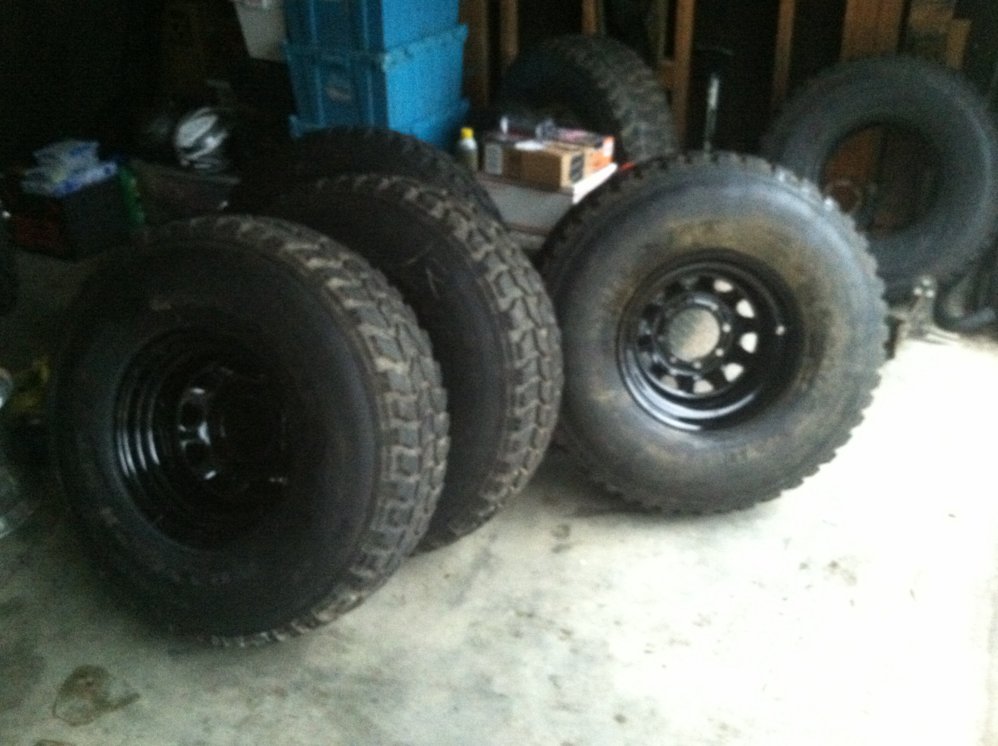

Hey guys,
Looking for some help mounting up a set of 37x12.5x16.5 Goodyear Military tires on new 16.5x9.75 Pro Comp steel wheels. The tires had been stacked for a while and I couldn't even get ether to seat the bead.
Discount Tire mounted the wheels but could not seat them, plus two of them are over 10 years old, so they don't even want to mess with them anymore. Need to dismount them, set pieces of 4x4 wood inbetween the beads to loosen up the sidewalls, sit them in the sun for a day or two, then try to seat them again.
Basically need someone who likes cold beer or willing to take a little cash and has a tire mounting machine, cheetah tank, or not afraid of good ole' ether.
Thanks in advance for any help!

Big thanks to the guys at Piedmond Truck Tires off Glenwood/Lumley in North Raleigh. They had all 4 mounted within 45mins. Never really dawned on me to try a truck shop that specializes in PITA tires. Not to menitoning getthem them put on for $20! Would recommend them to anyone on here.
