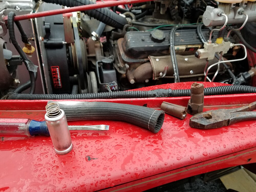

I am about to loose my mind over this jeep. It continues anialate spark plug boots and fairly consistently it's #5. It does this about every other day.
The setup is TBI 350, rams horn manifolds and LS/GM style metal heat shield and fiberglass sleeves.
Looking for help.... Currently I am considering
1: setting it on fire
2: LS swap
3: Ceramic boots
1
This was a problem with the new 7.3 Godzilla from what I've read. Fire Core wires seem to solve most of it. Might check and see if they make them for your application.
