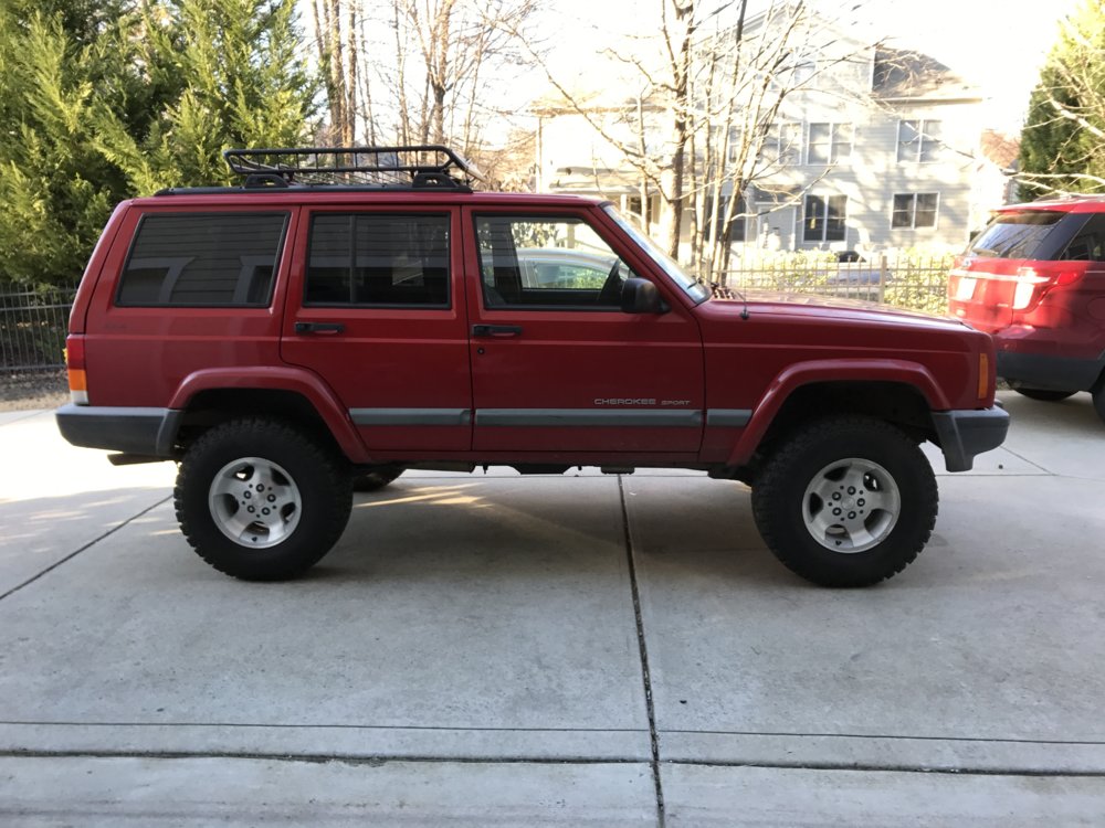

So the 99 XJ has 218k. It's a bit worn- has the low oil pressure thing, leaks a little here and there, but not obscenely. THis is now JR's rig for his DD- school, lacrosse practice and to his buddies houses. Not a lot of driving.
I'm into this for $4500 at this point. I feel that I could sell it locally for about that- like new DC FC2's, 3" lift, super clean interior, amp, radio etc. Ohh- almost forgot the roof basket- that's cash for sure!
Anyway- I'm not able or inclined to do a engine swap on my own. My trusted mechanic says his labor is ~$1k for a swap. He recommends reman (thinking that's $2500ish?).
So my question is- run it till it gives up the ghost, sell it now & get something else, do the engine swap.
What's the thoughts on reman vs used. Is that labor reasonable?
Thanks in advance for your feedback!
Here's what an XJ looks like. :fuck-you:
