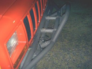

I've built several out of 2x4 and 2x3 rectangle tubing. Angle cut the ends and add some simple tabs and you got yourself as plain a bumper as it gets. Play around with different angle cuts 18 to 24 inches from each end and you can add a more curved look that will follow vehicle contours. Square small shapes usually ends up looking small and "stick built." Warn makes some bumpers that are straight forward and can give you some good ideas. The only picks I have currently of personal builds are probably more complex than what your after, but here you go anyway!

Made this in about 2 hours, cost $10, 1 5' piece of angle iron .250.
Minimal welding.
Fugly: yes
Fits stated criteria: yes
