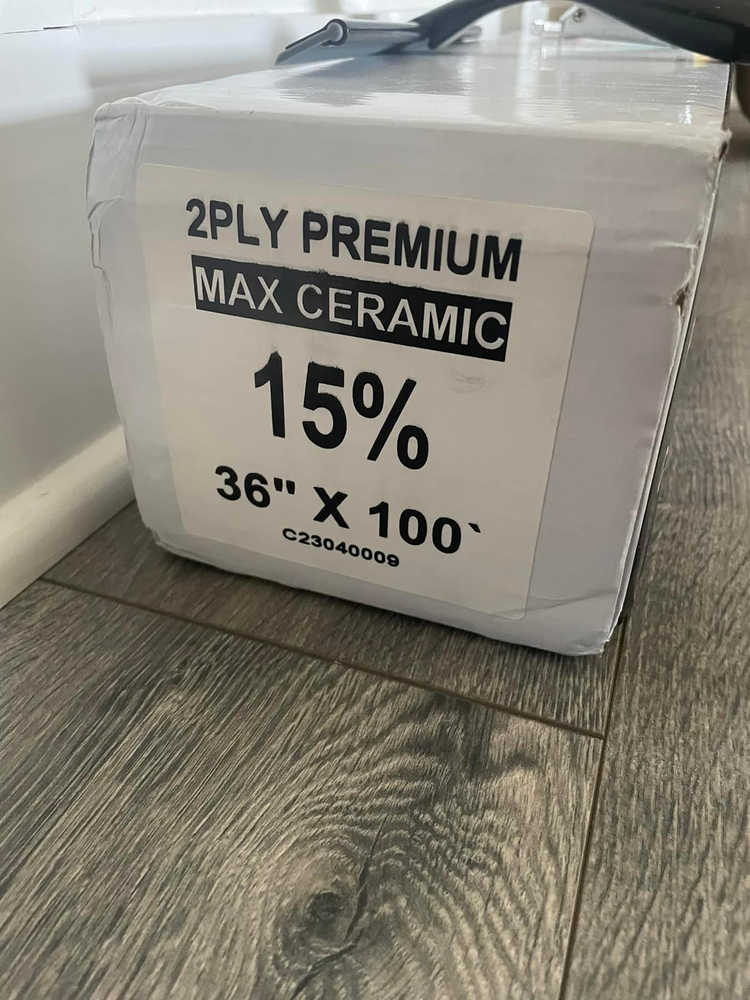

I'd never even thought about this, but someone in our neighborhood just sent something out about it. This is what he used
Ceramic tint is worth the extra $$$ imo.
Ceramic dual reflective tint
A1 choice

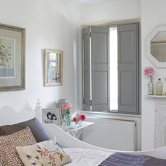

Alternative, build full sized interior shutters with glass panels, and ceramic tint that glass.

We used something like that to black out part of a conference room at work. It was static cling though.

Another vote for ceramic film. You don't have to go to a dark colored tint for it to be effective. Just about all the major tint manufacturers make a high VLT ceramic for these applications. HuperOptik, Llumar, 3m etc.
