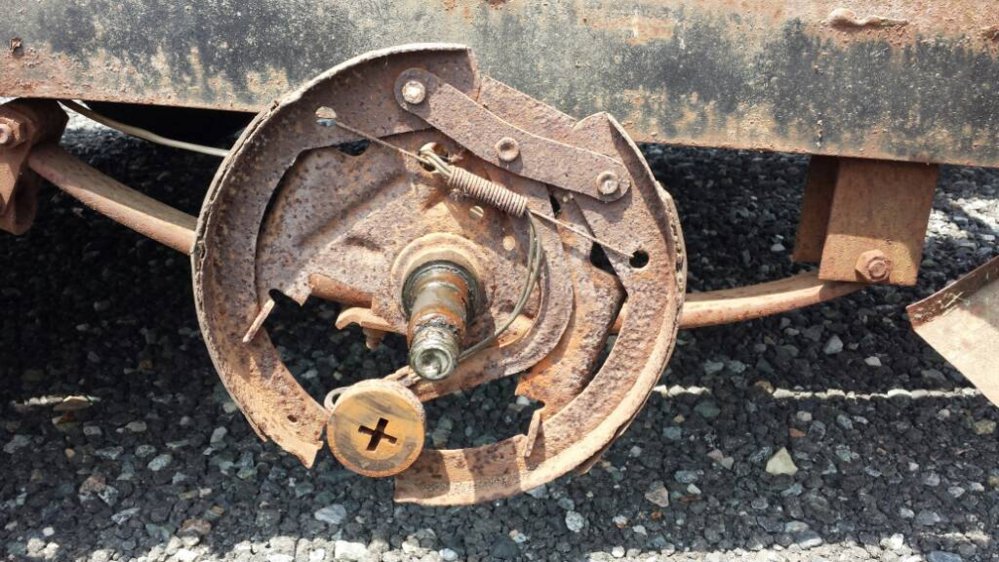

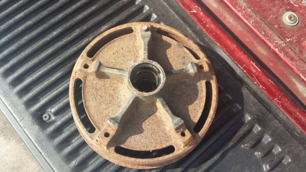

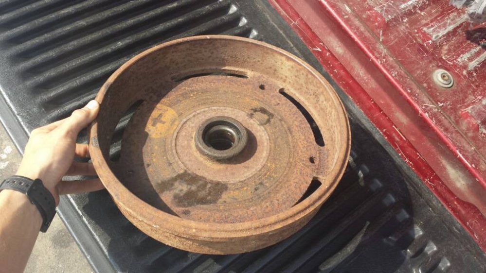

I was wanting to put some new wheels and tires on my trailer and was going to put new hubs on it in the process. I took one of the old ones off and took it to a local store and was told I couldn't change the hubs. Just wanting to make sure that's accurate. If so I'll just try to find some tires that fit the current wheels. Any help is appreciated!

The answer has a bit of variety as more than 1 manufacturer made MH axles and a couple different styles exist.
On my old axles 6,000lb Dexter Hub assemblies were a direct replacement.
Ive actaully converted about 6 sets of MH axles with standard 6,000lb hubs, but I have also ran into one that the bearing size wasnt a match...
Northrn carries the 6k lb dexter assemblies and is easy to return stuff to if it doesnt work..
Just went and pulled an old receipt...you want a Dexter Part # 42655 assembly.
If you want to order it : http://www.crofttrailer.com/42655-6-on-5-1-2-hub-assembly-6-000-lb-pair/#page=page-1
If you want to keep the brakes that's a whole lot more work...and involves cutting and welding and then the part cost and time equals a new axle.
I think a 6k Dexter straight with ez lube...is about $490 from Trailer Parts 4 U in Greenville, SC
