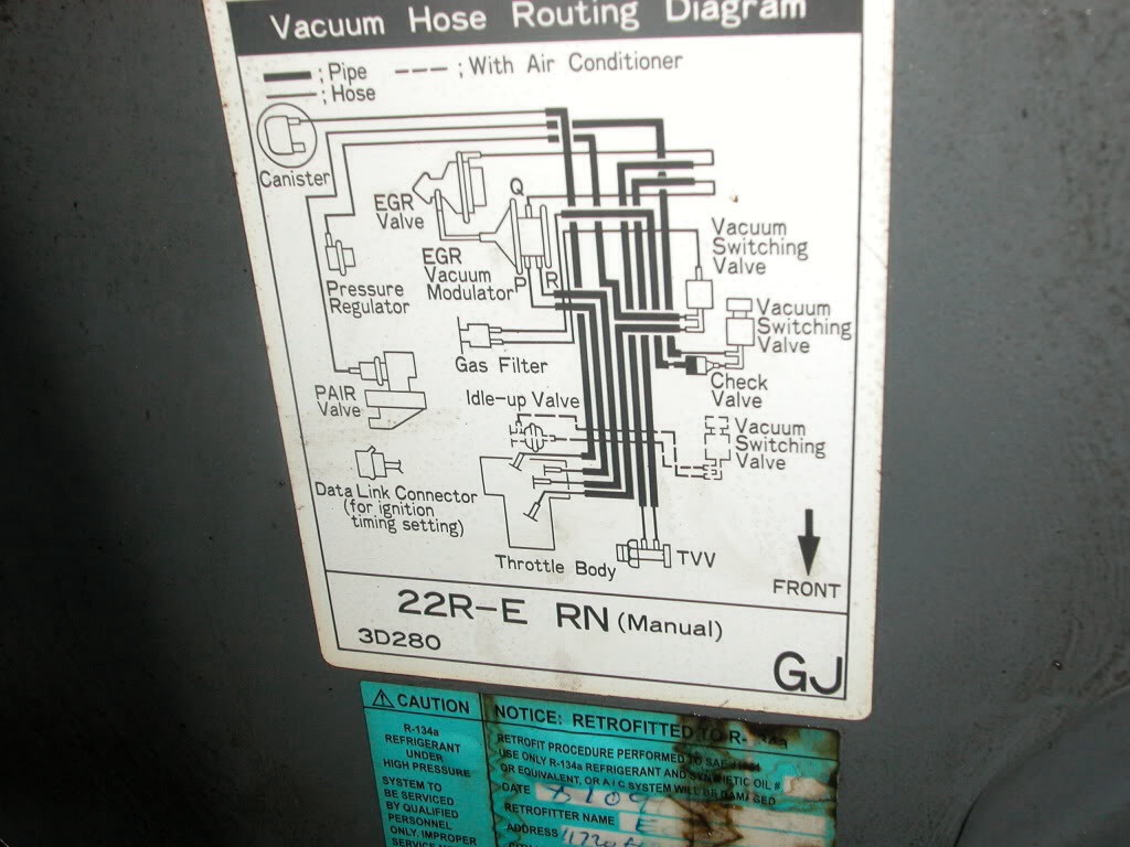

Anybody have pics or a diagram of the vacuum lines on a Toyota 22re my buddy took his head off and took all the vacuum lines off and didn't take pictures and I don't have my Toyota anymore thanks
