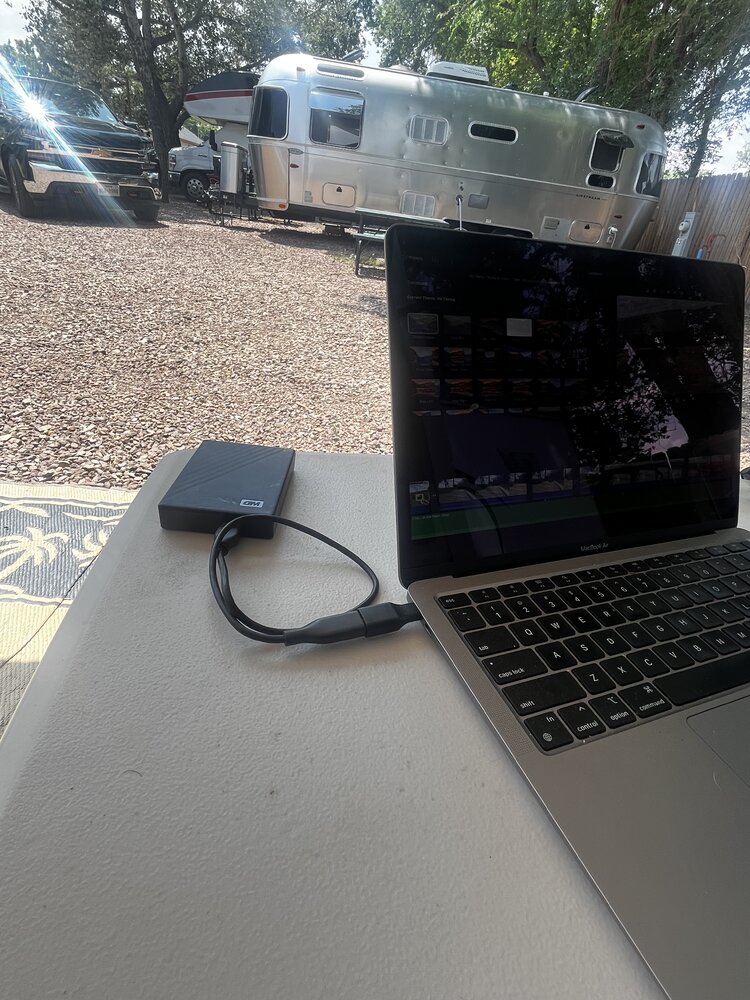

What type of connection is your external HD? USB3.0 or better should be in most cases, okay for editing, SSD for sure would help with speeds there.

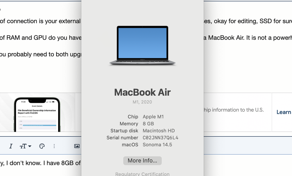

What kind of RAM and GPU do you have? I bet a fair amount of it is caused by using a MacBook Air. It is not a powerhouse system made for editing.
Honestly you probably need to both upgrade your computer and drive.
Honestly, I don't know. I have 8GB of memory and 245GB storage-177 of which is available.
This was like a $750 laptop from Costco so it was certainly entry level.

I believe this is a USB 3.0 to a USB-C adaptor.
I was under the impression when I ordered it that it was specifically for Mac and that I wouldn’t have any adapters but this is how it showed up.

By your pic we wouldn't be able to tell if its actually USB3.0, so I'll just assume it is

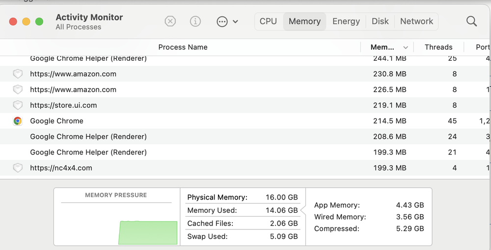

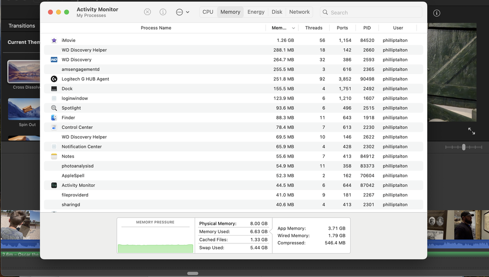

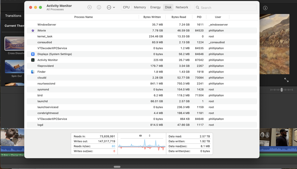

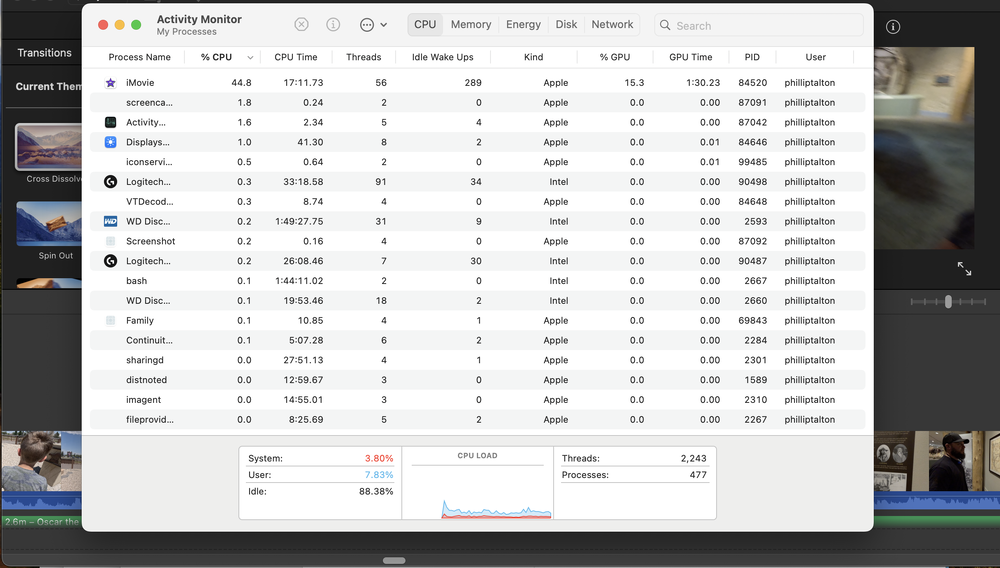

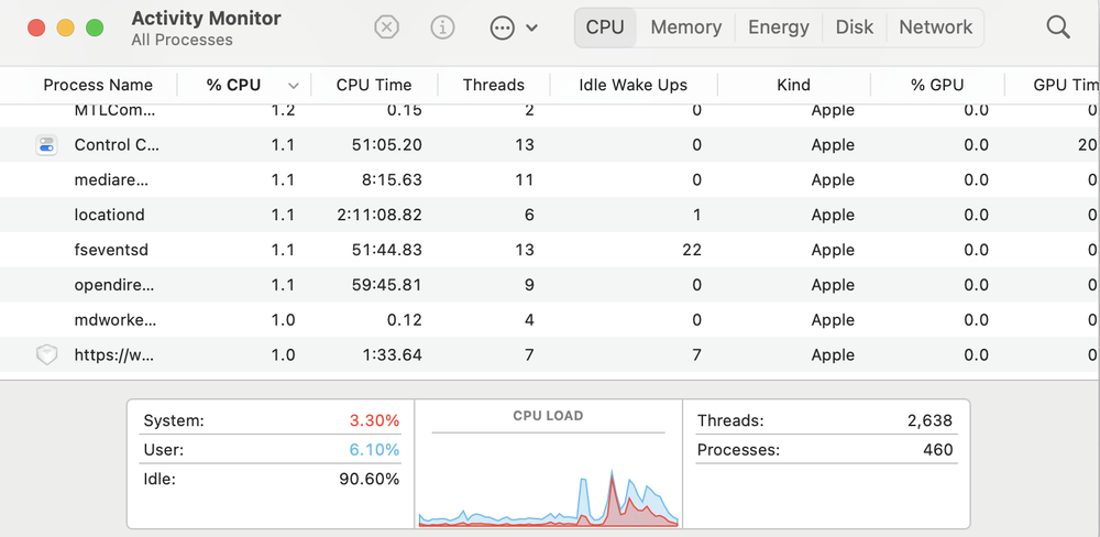

8GB of ram on an M1 processor doing video editing I bet you are using a lot of the internal HD as supplemental ram.
If you really want to do heavy video editing, 32GB would be the min I would look for.
Open up activity monitor -> Memory, when you are editing and stuff is skipping around, what does the data look like there?
Then also take a look at your CPU load
