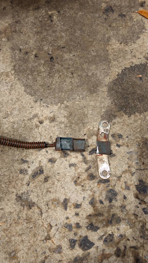

I cracked the cam sensor when I pulled it out to pin the distributor to set timing so I am going to swap it tonight and see what it does if it's not it than I'll head to the dealership Monday for a cps I kinda of think it's the cam because of the miss it has almost feels the a dead plug when it's missing

Cam sensor on 99-01xj controls fuel injector sync so definitely start there...that's more than likely ur issue..also no start when hot is coolant temp for ecu related too so check voltage on that sensor too
Yea that is how I broke the cam sensor when I pulled it out to lock the distributor it cracked what way do you do it and I'll do it again while I am changing the cam sensor

Fount the hard stating problem cps but it still has a horrible miss but no codes so I am thinking it's fule related
Sent from my XT1635-01 using Tapatalk
Look into setting your cam sensor properly..those are crucial to be just right like Jody said
