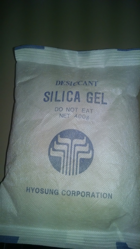

We have huge amounts of 1 pound desiccant bags here at work, they come in some materials we buy. If you need any I can grab some :)
Which begs the question why do they all have to say " Do Not Eat".... fuck'n ppl....
I would love to get some of these.
ai1294.photobucket.com_albums_b604_dirkwadeparsons_Mobile_20Up18a03ff0c4f1d37a79aa6800a383e3e5.jpg
Just let me know when your down this way.
