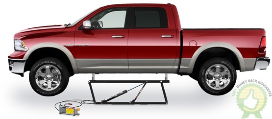

Someone needs to make 1/2 of a Ranger Quick Jack (for one side only) that works on 12V.
awww.quickjack.com_media_catalog_product_cache_1_image_455aee98e0176f6c7a79a6f4d861e367d4c5d36.jpg
