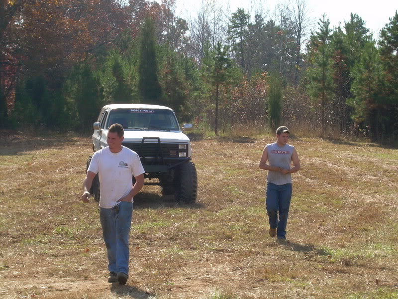

And he walks away with Pride.......
Backs blazer off trailer with like z-71 tow rig
like lines up to mud
gets about like 1/3 of the way and breaks rear d-shaft at weld
after a while, hits mud a few more times in front wheel drive-with like alot of speed.
Gets like major stuckness every time.

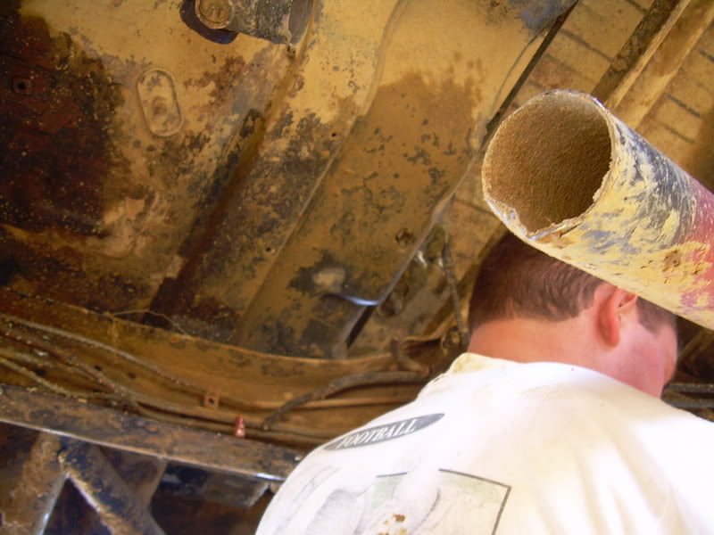

LOL....I guess the welds broke on the drive shaft. :D Looks like a clean break!
Ricky brought it up to me, since it's well known I have a welder. It's a thin wall tube. Looked like it had been sawed just before the yoke, and welded back. Must have been a cold weld, it was pretty clean break. I suggested a different drive shaft. Anyway, he wasn't through playing, so they hit it in Front wheel drive. Several attempts. All stuck. Jim pulled him out.

yea driveshaft broke where I had welded it, gives me an excuse to make a 1/4 thick driveshaft instead of trying to reuse the stock shaft like that was.

the only question is if you couldnt make a weld penetrate that thin wall stuff, as evidenced by it breaking off right at the weld, how do you plan on properly welding a .25 in tube shaft?
Quote: jrraw23 = "As far as penetration, I think I need a little more practice on that but I'm getting close." :)
:shaking:
Nah the reason it broke was that was the stock shaft. I had cut it and re welded it back together to shorten it for the 14 bolt. What i did was weld tube to tube. Thats why it brokethe stock tube was to skinny and the tube to tube weld wasnt strong enough. I should have welded the tube directly to the yoke when i shortened it. Penetration wasn't really the issue just improper driveshaft shortening technique :rolleyes:

Hate to say it bub, but weld penetration was the problem
If there had been adequate penetration, you would not have had such a clean break. Hence what I said earlier, it was a cold weld. you only penetrated the outside of the metal.

Aight I'll just turn the heat up more next time, I figured it broke so clean cause after I welded it I grinded it down to where the shaft was smooth and you couldn't tell that it had been welded, which also probably grinded away most of the strength the weld did have, also a bad idea in retrospect :shaking: .
Honestly back when we welded the shaft up like that we were trying to get a quick fix for him to get the blazer home, I knew it probbaly was not gonna hold and I told him that but we did it so he could get it home with the full intention of remaking the driveshaft later on then we both totally forgot about the driveshaft not being done :shaking:
