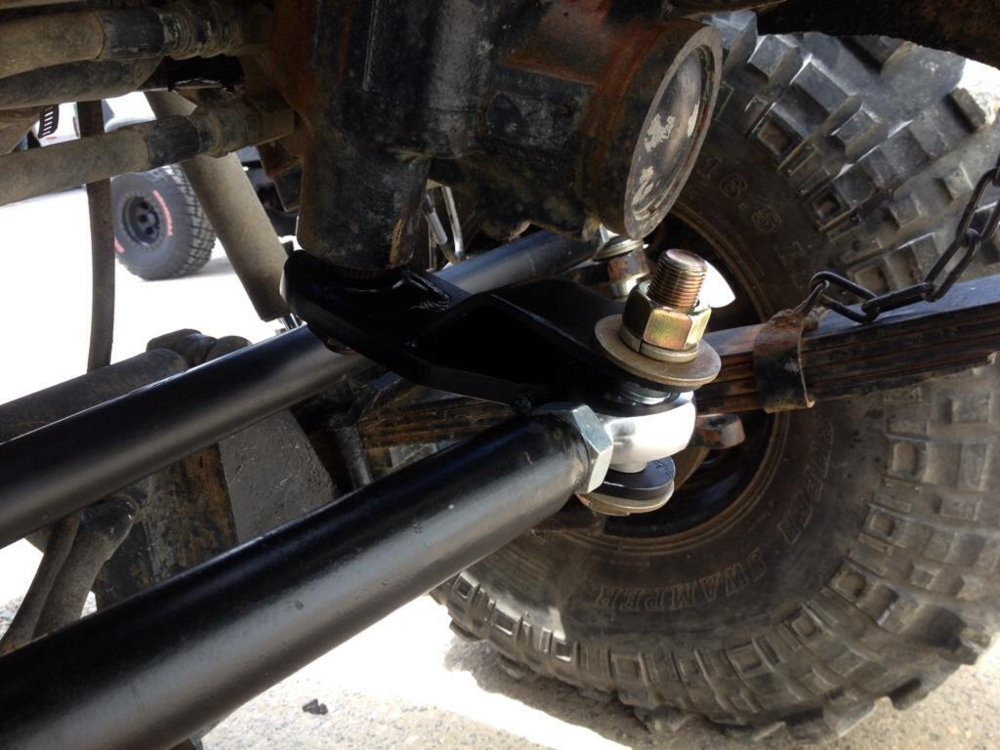

ai552.photobucket.com_albums_jj335_jrhxj1_Mobile_20Uploads_IMG_20150528_214622072_zps2xvcyzkf.jpg
What I should be running in reality is the Artec arms. Double shear tie rod, full knuckle tie-in, etc, like this cat I wheel with. But of course I can't afford nice things. :lol:

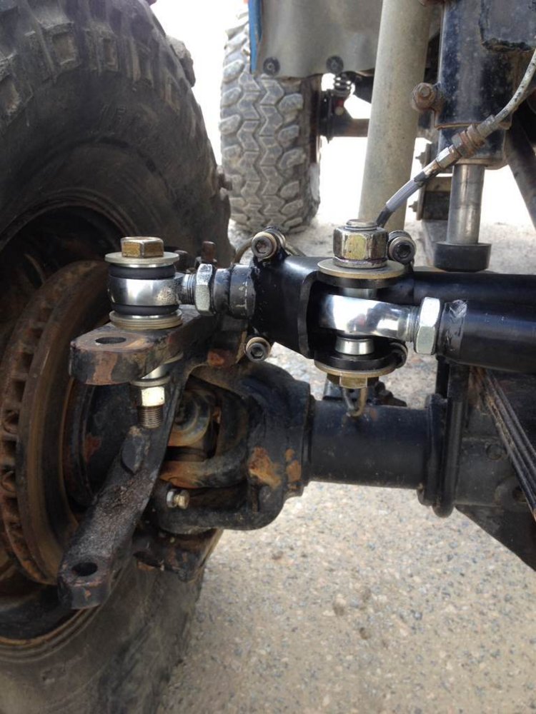

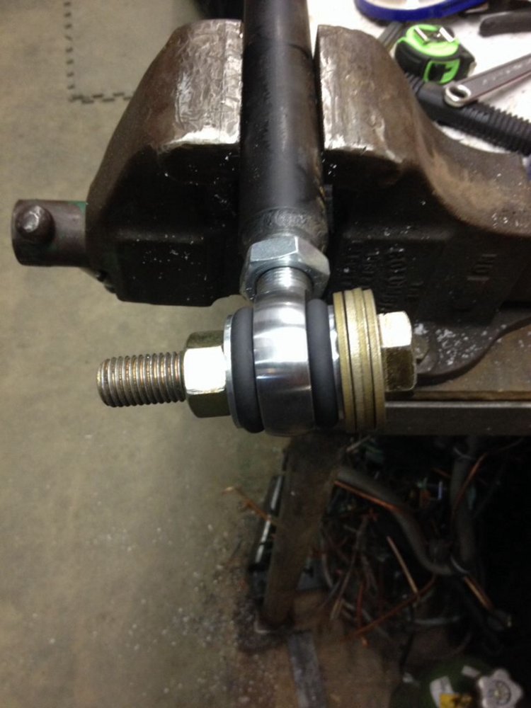

When swapping to heims on my steering, this is what I considered.
The angle of misalignment is practically the same on a 3/4 ton GM TRE ( the ones everyone calls 1-ton, has 7/8-18 shank) as it is on a commercially available heim with 3/4 bolt with misalignment spacers.
Both are ~35 degrees total misalignment.
Yes heims can't be greased.
The boots never stay on TREs longer than a few months and the grease attracts and holds dirt. Tolerance on heims keeps a lot of big particles out, and can easily lube the heim with cheap spray lubricant like wd-40 if desired.

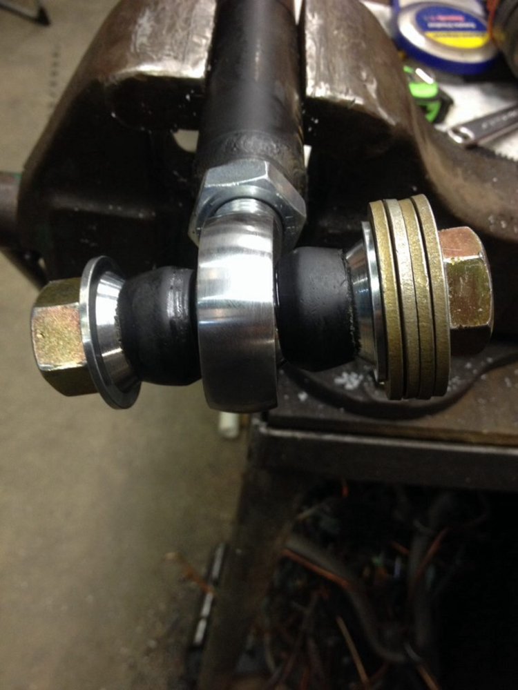

I mounted both ends of my drag link heim in double shear. So even if the heim comes apart, some type of mechanical linkage still exists.
My tie rod is mounted in single shear, but with large safety misalignment washers. Even if the heim comes apart, the shank will remain attached to the steering arm. This is why I purchased the steering heim set from Barnes, just to get the additional safety washers.

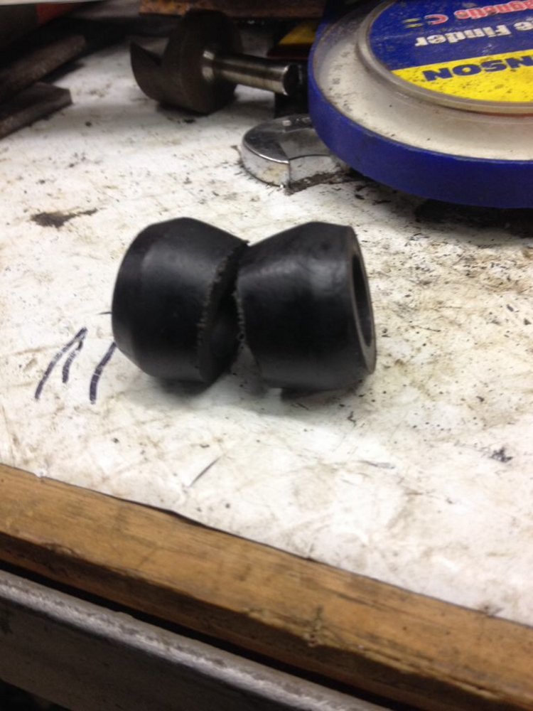

As far as the tie rod rolling, I took polyurethane shock bushing and cut them in half, then compressed them on either side of the heim, between te safety misalignment and the heim body, to limit the misalignment and I keep it from flopping. Works great, and cheap & easy to keep spares.

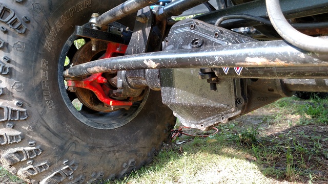

A few pics of my current setup.

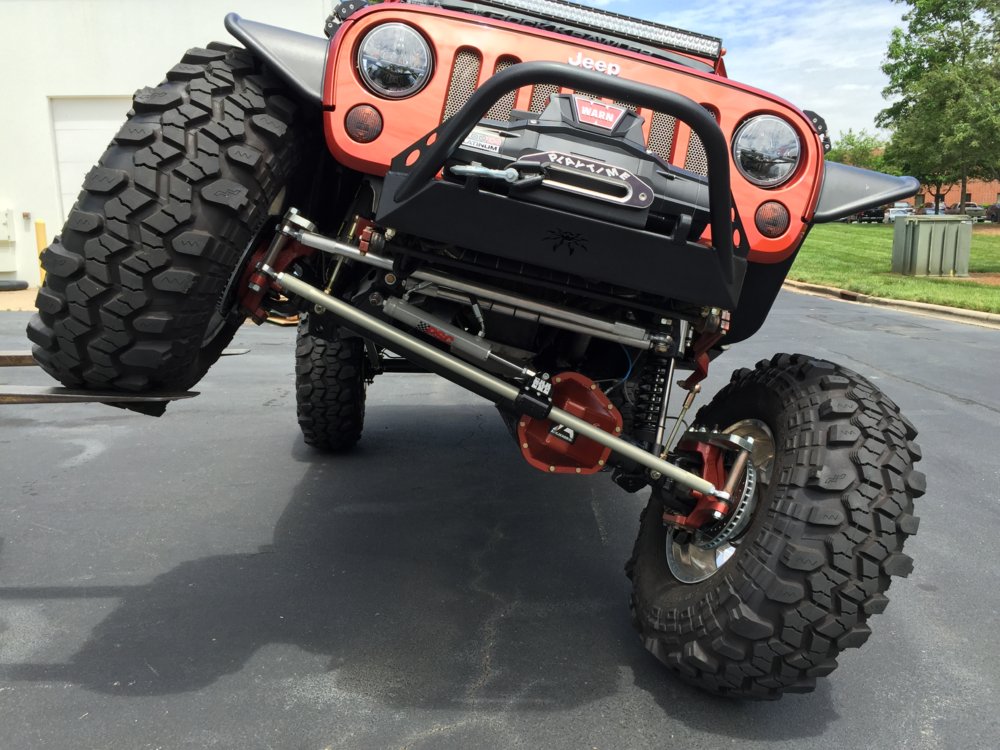

I'm going to steal your shock bushing trick. I need to keep my tie rod from rolling with the hydro assist. Thanks for the idea. Here is a picture of my 60 steering. I'm using Solid Knuckle with Artec Arms. I went with this setup because I like to drive my Jeep when I can and I felt safer knowing I had the keyed knuckle instead of all the steering force riding on the high steer studs. It also allowed me to get my drag link and track bar lined up for no bump steer.
@ABadJeeper Your steering angles look dead on! Nice ride! And yeah I'm stealing mac's idea too. :D
Thanks it's been a fun build. Ideally I'd have a longer track bar but without cutting the frame in half it wasn't happening.
I started with rubber ones, but they were too soft.
I was going to draw something up and machine them out of delrin but your solution is just to simple not to use. That's why I like this forum.
