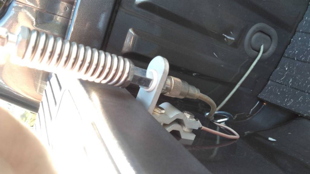

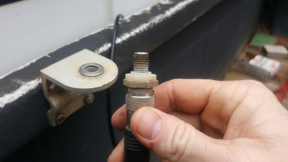

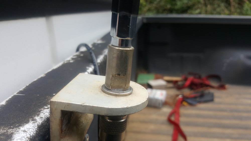

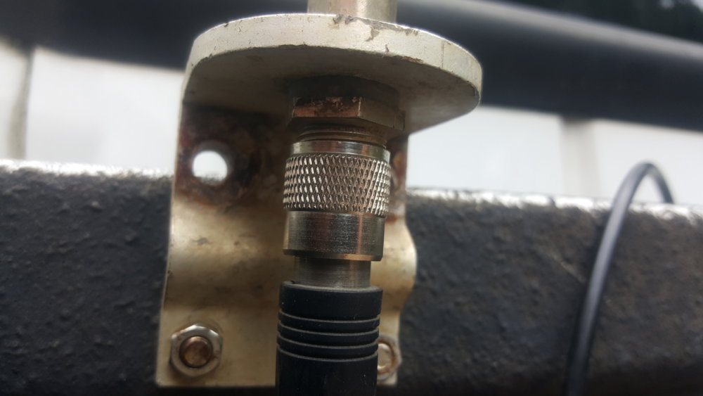

I am attaching pics of the antenna mount.

If the antenna you are using is not a NGP antenna with the appropriate coaxial to supply the ground, then the antenna should have a very good ground to the vehicle.
Sounds like you have it installed right. So no "loops" in the coax? If so you should zig zag it instead. If you have much slack you can loop it right where it goes into the antennae mount and zip tie it, it can change your readings. If you are on FB try asking here CB radio show and tell !
Loops don't affect SWR. Antenna ground needs to be grounded to the chassis, unless it's a ngp antenna with all the matching parts.
Behind the cab like that isn't a good location. The cab affects propagation. But it shouldn't have a huge effect on SWR.
I'd scrape some of the bed liner off under the bracket if you could.
At the very least, run a 10 gauge wire from one of those mount bolts to the frame under the bed with ring terminals and star washers. That way you are 100 percent sure you have a good ground.

I just looked at the pictures again, you need the plastic on top. Heres my setup on my f250. I doubled the bracket as a spacer.
The coax adapter should be grounded to the chassis and the center post should not. If you have an ohm meter you can check that at the cb end of the coax to check the cable and mount. The screw part should be grounded on both ends measuring with the meter, close to 0 ohms. The center pins should not have any resistance (open circuit).
The plastic cap will change the swr. And I've seen a difference if the antenna is too close to sheet metal like the cab. I couldn't get a good swr on my trail rig behind the cab so I moved it back on the exo cage towards the rear. Back there the swr is <1.5
Sent from my E6910 using Tapatalk
Doea your plastic isolator go all the way through the mount hole? Mine only goes half way through. You have no plastic part of any kind on the bottom of the mount?

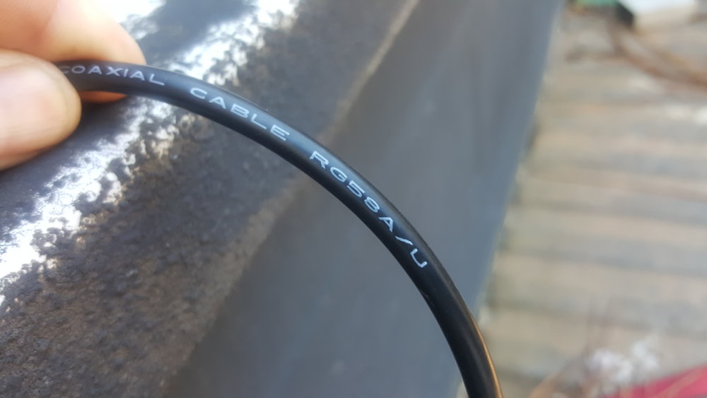

How old is the coax? Pretty much every time I have gotten high SWR's I had a bad spot in the coax.
There are three different tests with an ohm meter to check the coax. Disconnect both ends of coax. Check continuity between the center of each end. Should have continuity. Check the outer part of both ends the same way. Again should have continuity. Then check between center and outer. Should not have continuity.
With the antenna mounted as it should be (insulator on top) and coax disconnected check for continuity between the bracket and the bottom metal part of antenna just above the insulator. Should not have continuity.
On the bottom of mount, the outer part of coax fitting should have continuity with the bracket but not the antenna.
The center part should only have continuity with bottom of antenna.

There IS continuity between the outer part of coax and the antenna.
What does that mean? All other tests were good.
Somewhere in your setup the (most likely in the antenna mount) you have a short. The center part of the coax to the antenna has to be isolated from the ground. Without having hands on, my best guess would be the adapter piece of the mount either has an internal short or is not arranged correctly to prevent the short.

3-the mount needs to be WELL GROUNDED to the truck bed. Scrape off the bedliner and paint. Wouldn't hurt to ground the bed to the frame.
4-might not hurt to clean the threads on the stud and the antenna ..... they look pretty grunged up.
Now, since the adjuster is all the way down and the swr get worse as you go out, the entire thing is too long. Needs to be shorter.
Try it without the extra nut between the antenna and the stud if it will work then adjust it.
