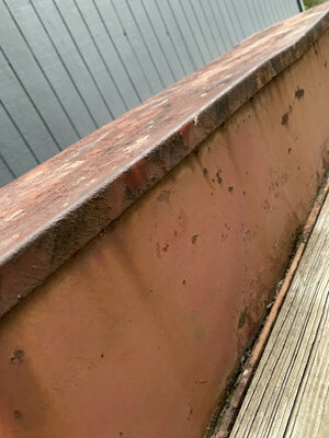

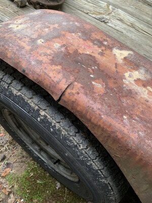

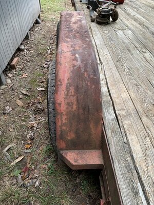

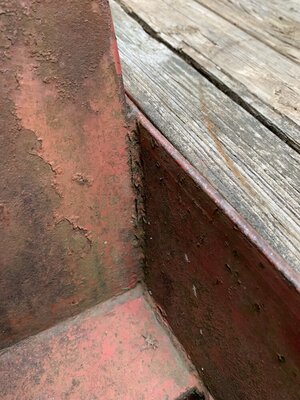

I bought a 16ft car hauler a few weeks back and everything has worked good so far, hauled my 62 Chevy II, my XJ and our TJ on it thus far with no issue, however I just realized that once I get the new drivetrain under my XJ, it’s gonna be just a tad too wide for the fenders on the trailer. It’s gonna have a D44 front and D70 rear with 37x12.50x16.5 on it and those are looking to be about 79” wide with the inside of the fenders on the trailer measuring 76”.
The fenders on it currently have seen better days for sure but they still serve their purpose. Question is, cut them and hinge them Uhaul style (or replace with new ones and make them hinge), cut them off and run without fenders altogether, or reinforce them to be driven over top of?

Stand 2x6's up on the inside and secure to fender.
Cut them off. I bought my Kaufman trailer with removable fenders because my old cab truck was too wide. I took them off, and I don't think I've ever put them back on.

I guess the only downside would be road debris getting thrown up. That might matter if you ever tow anything nice. Not a consideration for me.
I'm not sure what the legalities of no fenders are...
I had tires blow and damaged my removable fenders so we towed from GA to Moab and back to SC with no fenders and didn't have any issues, but I'm sure people behind me didn't appreciate it.
Lots of equipment trailers come with no fenders, i used a pair of them for years and it's nice for a lot of reasons, including forklift loading things and loading trucks. Now I've got deckover trailers and the trailers with fenders are 1/4" drive over diamond plate fenders, really like when it's raining or muddy not making a rooster tail of it.
My vote is just weld some 3x3" angle iron to them and make them drive over fenders
Not a bad idea, seems pretty easy and straight forward. I wonder how much of a PITA it would be should my rig ever break and need to be winched up on the trailer and over the fenders. Trailer does have an 8k winch on it
Not as easy as with no fenders but no tougher than going up the ramps
@Bebop fenders arethe shit for sure. But, if you wanna make them work on the cheap,... I'd add a support under the fender, between the tires, add a piece pf plate to the top of the fenders, and then put two married 2X's bolted through the fender to widen it on the inside. From what you said, you have 3" wider than the inside of the trailer between the fender wells. so 1.5" On each side. adding the layered 2X's (6, 8, 10 or 12 depending on the height of your fenders, will give you a lot more tire area going over them. Also, cut the 2X's at a better/ramp like angle, so you can traverse the span easier.
My only concern with this would be making it too narrow inside the fenders to haul other non 4x4 vehicles
I still say the best compromise between no fenders/drive over I've seen was Ricky R's... "drive over" fenders made of conveyor belt and no hassles
I would never not want fenders on a trailer; no sense kicking up rocks and debris on whatever you are towing not to mention the mess it makes when it rains or if your tire has a blowout. It's one thing to fling stuff off onto the road and quite another to have a tire damage whatever you are towing on the deck. My Kaufmann has bolt-on removable fenders; I rarely use the feature but when I built my truck it needed to be <80" wide to slip between the fenders and that was a design constraint. You can always get wheels with backspacing that pulls the tires inward a little bit, especially on something narrower like an XJ, but 76" will still be really tough. Hinging is nice and I may change mine to do that at some point.
