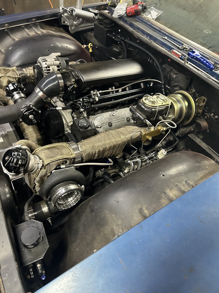

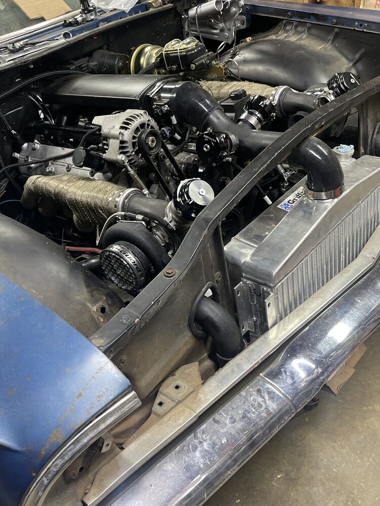

Blah blah… got the terminator x max kit on my turbo car. Blew the rear and, fixed that with a 40 spline 9”, 2 miles later popped the trans. Got a new built one for it. But while backing it into the shop it’s running fat. Notice the handheld is showing 11v. Cut it off and goes 8.x volts. Check everywhere and I’m 12.6 off and 14.x running. Checked the voltage going to the ecm and the same. But the Holley is somehow reading the lesser. Anyone seen this issue. Gonna call Holley tomorrow but of course they are only open when I’m at work…… so I know they are gonna want me near the car
