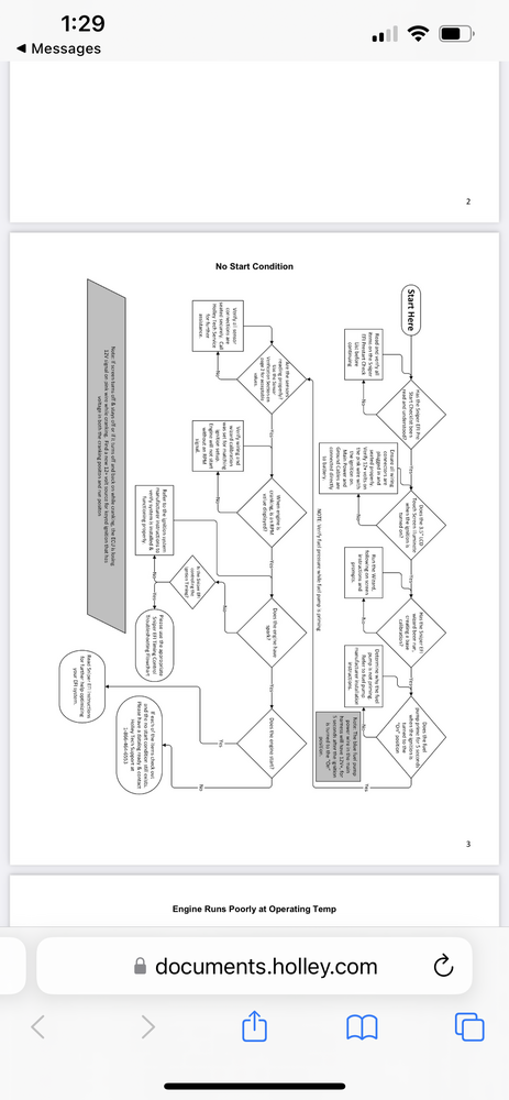

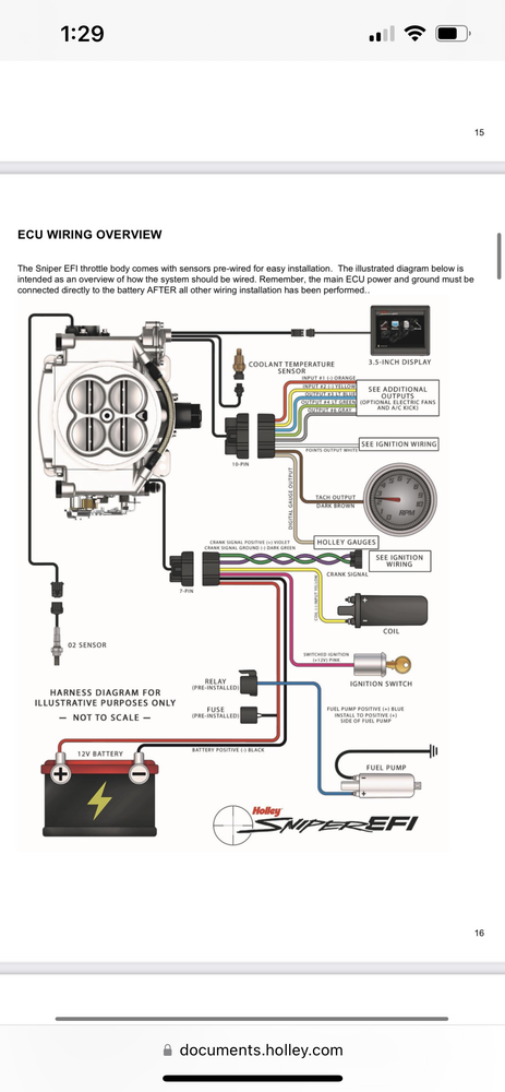

My brother had a guy install a Holley Sniper EFI. Ran OK for a bit, but it shuts off at random because of a drop in voltage. I’ve read they’re super sensitive, and will shut off if it drops below 12v. At the moment it’s powered full time from the battery with the startup wire (pink) tied into the ignition as the directions call for. Problem is, the voltage drops on the ignition wire on startup thus getting a no start. It has a 140 amp alternator, the battery is good, everything is charging. I know a handful of you have installed these. What 12v source are you hooked to that doesn’t drop on startup? I suggested straight to the battery with a toggle switch and relay, but he wants to keep it clean on the dash. Thanks in advance
(The bottom paragraph in gray is our issue)
I run all my 12 volt ignition sources off of a fuse block powered by a 60/80 amp relay. Power straight from the battery just use the car wire to operate the relay. Basically bypassing any old wiring for true voltage. There is also another chassis ground or should be. Not just the one to the battery

That same block powers up my Holley, trans side of the Holley, alternator field, and my gauges. Also have my fan on it for it to run with the switch on.

go directly to the ignition switch. one of the high current wires there will stay 12v during crank. if it is dropping voltage you are on the accessory circuit

I have my sniper wires directly to the battery and pink wire to the ignition switch.

Finally had a chance to look at it. Guy who installed it had the startup wire connected to an aftermarket fuse box. For some reason that box is only getting 10 volts on a hot key. Found the old electric choke wire and it has a solid 12 on startup, so I just connected to it temporarily. That works like a charm. Started it up probably 15 times with no issues. Drove it for about half an hour and got it up to temp. Plus I wanted it to learn. Came back, switched it off, and it has a hard time starting once up to temp. The saga continues. I don’t think it’s a voltage issue anymore. Something else is happening when it heats up under the hood.
