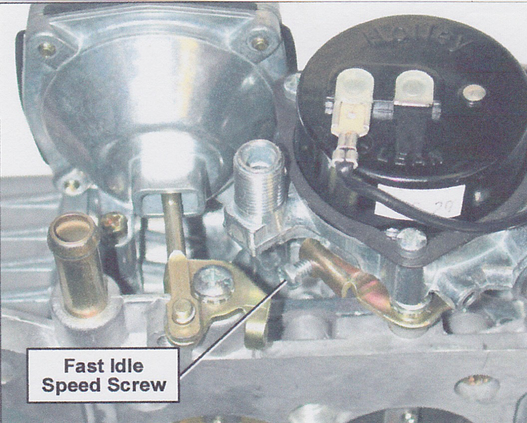

The fast idle screw engages a cam that is engaged by your choke. Basically, when the engine is cold, and you pop the throttle a couple times before you crank it over, the thermostatic spring in the choke will close the choke flap and advance the fast idle cam. It sounds to me like the screw is backed off some, but still touching the cam. Once the engine is warm, you don't need the screw touching the fast idle cam at all. If it is like some newer carbs, the cam will have several steps in it anyway. I'd back that screw off more until you find the idle in a happy place for you. I was going to say "not touching the cam when the engine is warm," but after looking at the fast idle setup on the truck avenger, it seems to be different than some other 4150 Holleys. Visual aid shown here:
fast-idle-screw-jpg.70160
I'd back it off some more. What does the engine idle at cold? I'd have to assume pretty high. At least back it off until your regular idle screw is actually functioning for you again.
