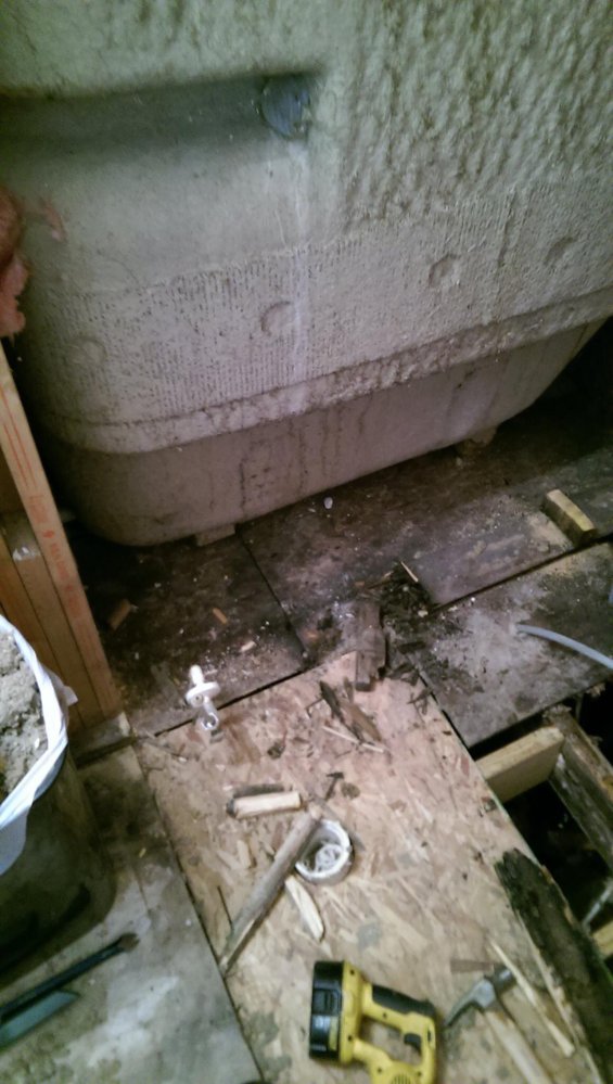

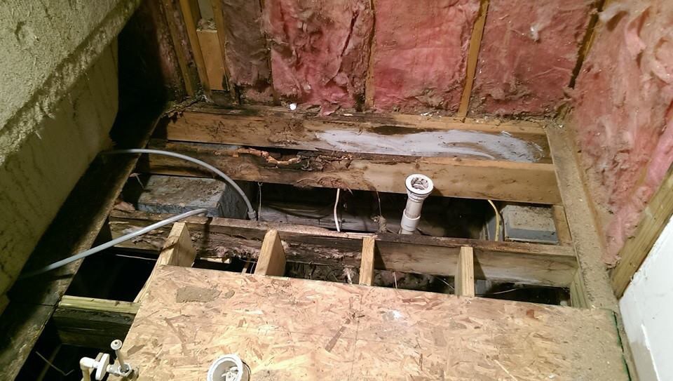

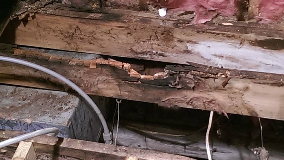

I used a pretty reputable home inspector and feel it was a waste of my 400 bucks that I paid him. We had agreed on a time to meet at the house and when I got there he was already there and said he had been there an hour or so. (Red flag one) there were many other issues that I feel should have been in the report and would have given me some things to negotiate on price. The biggest issue that pissed me off about his "inspection" was he said it looked like the toilet in the master had leaked around the ring, and recommended the sub floor be replaced..... Just the subfloor I asked, he said yep.
So I had them tear out the floor and replace it befor we bought the house.
Yep it was just the subfloor.....
The new piece of osb is what they replaced.....
All this was visible from underneath....
Am I bitter lol yeah just a lil, but I also kinda blame myself for not crawling under there also. Kinda hard to do with a two year old in tow though......
And don't get me started on the mold............
