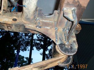

Like this? Just some ideas you can use.
Hanger out of 3"X5" 1/4" wall rectangle tube, 1/2? wall tube for spring mounts (looks thicker but don't remember), all welded together with 1/2" plate. In picture it's upside down.
Out of some box tubing
Or
5/8" plate
Exactly what I was looking for! I checked out your website and that is some NICE rockwell stuff you got going on. I'll be in touch for some shock tabs and hardware for sure. On that first pic though, how does the spring attach? Chevrolet rear style shackles? Hope to get some more posts from others too.
First pic would be like a rear chevy where the shackle's mount. I got more examples, have to find some pics.
My stuff is all hand cut/ground, I don't really do production kind of work. There are others on here with access to burn tables for slick looking tabs and mounts (mudpro & rides for example) but I can do them also.

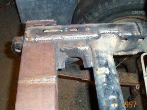

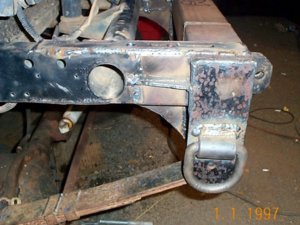

This may not help, but here are a few pics of the one I build in the front of my YJ. The center is 4 x 4 - 3/16" thick rectangle, and all other pieces and gussets are 1/4". The top plates that lay over the crossmember and go back onto the top of the frame are 3/16". The front frame extensions are 4 x 2.5", 1/4 thick I believe.

I like the D-rings on the side of that one. Might come in handy for winching or using a hi-lift on the trail! Anybody think I can fit 49" tires on a fullsize chevy using stock height springs???
