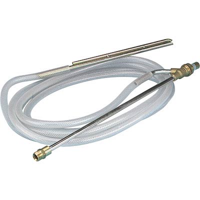

Several buds have used the cheap "pressure washer sand blasting attachment" & "Play Sand" with pretty good success to strip paint/rust from chassis/tubs. Little dust & no sheetmetal warping because of the water, but you'll have to quickly dry & seal/prime the parts or they'll flash rust within an hour...
