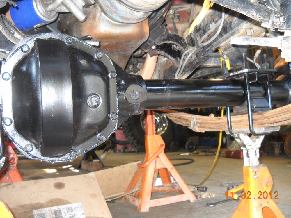

Stock Dana 44 thick cover with a 1/4" band added to the ring gear area. Made this one for a friend, I have Solid's on my stuff. Hard to beat for the price.
Sweet looks like out of all the pictures of home made covers I like yours the bests thank u amcjeepman

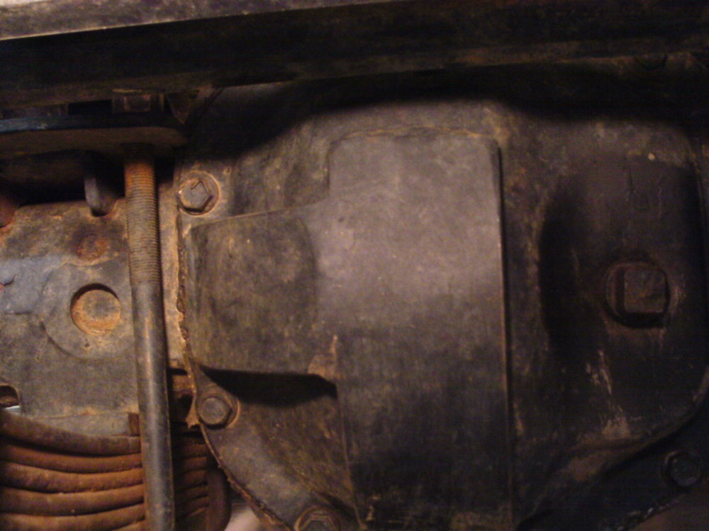

I can Vouch for James's covers, as I'm running that. The 1 pictured, ended up on the rear. Tie-rod didn't clear the front on, so James modified it. Not great pic, but you get the idea.
I do like that Syntec cover & price, but wonder if it would clear my tie-rod?
