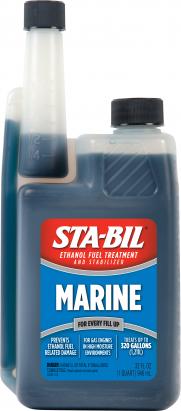

Mix some blu stabil with every tank.
Not red, blue.
It combats ethanol
awww.goldeagle.com_sites_default_files_styles_product_detail_m2297fc04e8a51d4fb7816a660aed0272.jpg
You can find it with and without the marine labeling...it doesnt matter the word boat just adds $2 dollars...

Water is exactly what im thinkin, the generator is new(maybe n hour on it) Ill give the blue stabil a go, I used red today.
