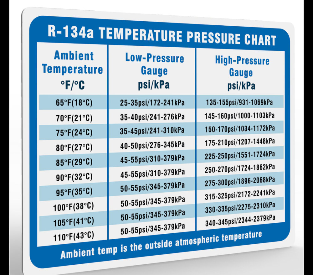

This will get you pretty close. Be hard to do here but your probably good in Florida
Ok…. So how do I get more pressure?
I thought jumping the relay location and manually kicking the compressor on would do this? Maybe I wasn’t patient enough? How long does it take to suck the juice (giggity) out of the can to help build pressure?
Was the compressor actually kicking on?
Warm the can up with a torch or heat gun. Or hair dryer. Or your butt.
