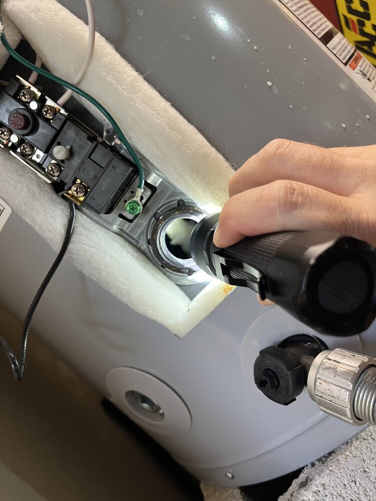

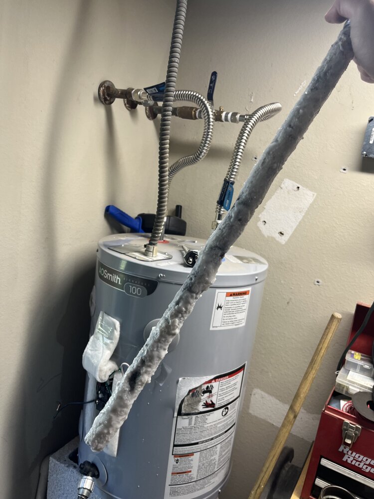

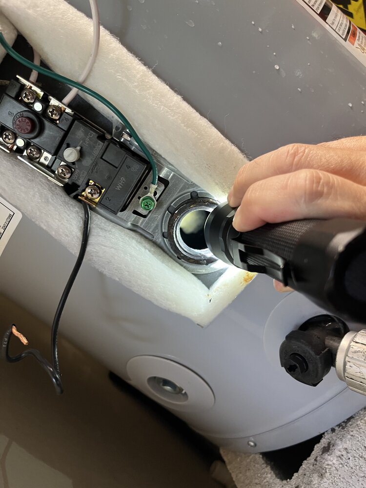

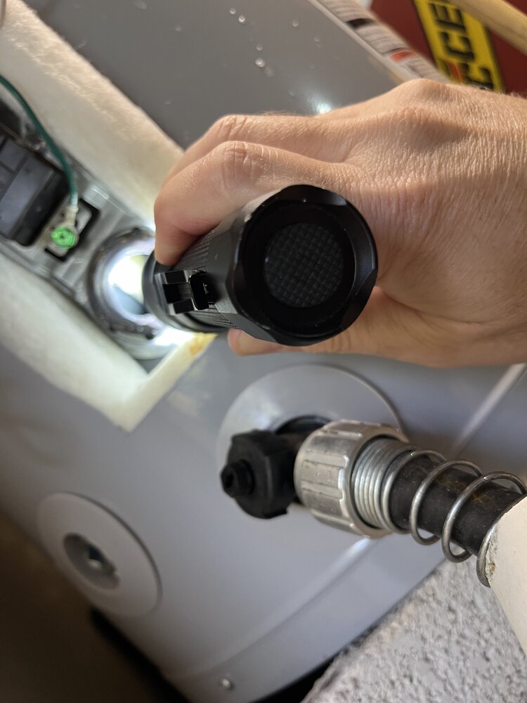

I pulled the element this morning and looked in the hole. There a long stalactite of what I guess is lime scale hanging from the top of the tank. Did my best of taking pictures.
I know we have hard water here, but this thing grew in 5-6 months? Damn!
That looks like your sacrificial rod. Your hard water attacks it instead of the tank and elements. You’re supposed to replace them over time or it can start ruining the tank.
Picture is hard to tell, could it be the anode rod?
If you have a water softener system you are supposed to replace the anode every 6 months
Aside from being hard is your water acidic too?
My guess is you have a lot of calcium carbonate around in that tank, it is sticking to the element and eating a hole in it.
Need a better filter coming off the water treatment.
BTW... thank you for the reminder I need to drain my tank and at least check the rod and probably change it. Our water is really acidic and eats rods quickly.
