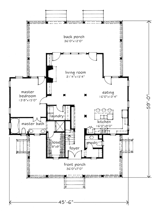

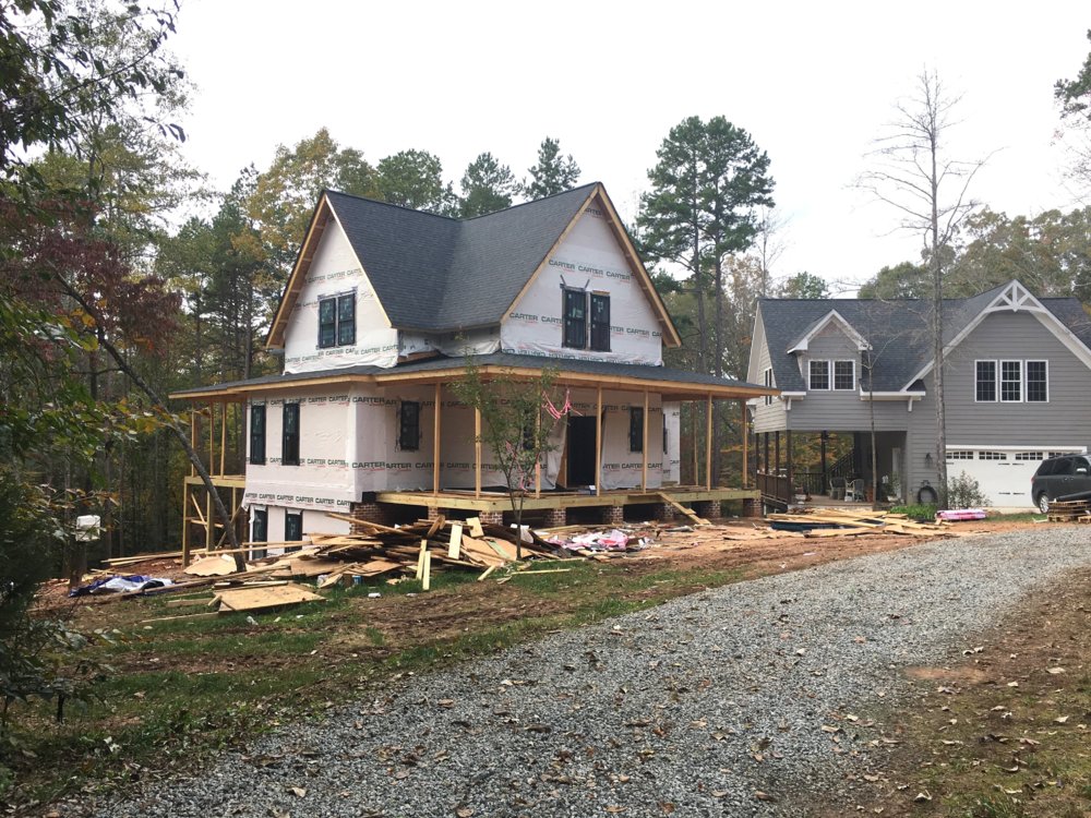

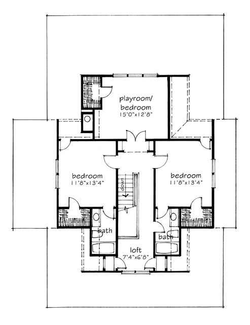

In the next 2 weeks, they will be doing insulation on the house we're building, and I'm tossing around a couple options. I currently have quotes of about $6000 fiberglass and $8500 for open cell spray foam. I plan to go with the spray foam because I really like the idea and see the benefits. Our current house is fiberglass batts and, in my opinion, has thermal performance issues because of improper batt installation.
The general layout of the house is a fairly simply 2 story plus attic above the entire 2nd story and full basement below the entire first story. All exterior walls are 2x6, except half of the basement is poured concrete walls.
I've read that there are different densities of spray foam with the higher densities having higher R values. I'm also aware of the concept of diminishing returns. Are there any advantages to getting it done with medium or high density closed cell foam?
Another question is to do the attic floor, attic roof, or both? And if both, what else needs to be considered?

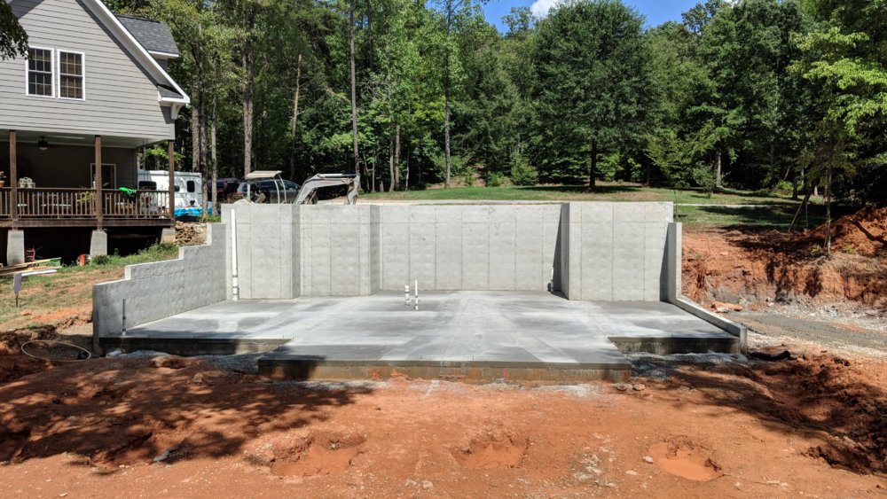

The biggest decision I'm deliberating is how to insulate between the basement and the first floor. I will have a wood stove in the basement, and plan to use that as a semi-primary heat source in the winter. I will be fully insulating the basement stud walls. I haven't yet decided whether or not to do the poured walls. But it seems like using really good insulation between basement and 1st floor would be a bit counter intuitive for the sake of heating.
Here's a couple pics and the general layout of the plan.

Looks like the roof and a roll air barrier have already been installed, so there are a bunch of options that are now closed to you.

Looking at the plans and the pictures, you're really not going to have much attic left above the bedrooms though, right? Just a little wedge...?
