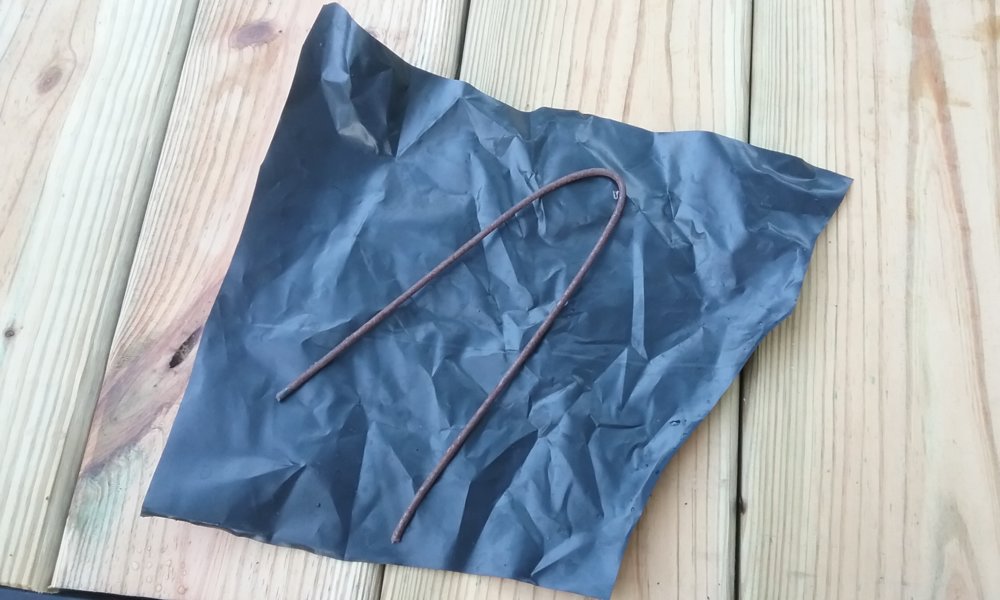

First, here's a true 6 mil plastic and fastener pin. Typically cut with a box cutter but you can tear by hand. If you think for one second companies will not try to slip in 4 mil on you hoping you won't notice, think again. Metal rusts when driven into the ground.

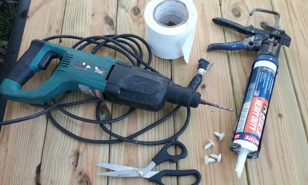

These are the tools of the trade on a true encapsulation. Hammer drill with 1/4" Ansi bit and 1/4"x1 button caps used to secure the 12 mil wall and pilars to cinder block and/or red brick exterior walls every 3'. Construction adhesive field tested to adhere the best to material and brick. Scissors. I defy you to tear any of it by hand. 4" white vapor bond tape that is so adhesive you can actually tape material together under water.

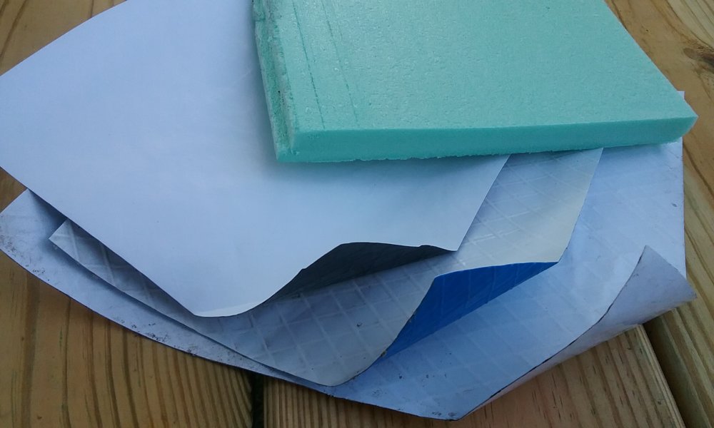

Here's some examples of materials used in encapsulation. Color coded. Black or pink back is 12 mil. Blue back is 16 and white back in 20. This is the real deal and its extremely durable. You can see the fiber reinforment in it. Also shown is 1" thick foam board field cut to block crawsplace vents.

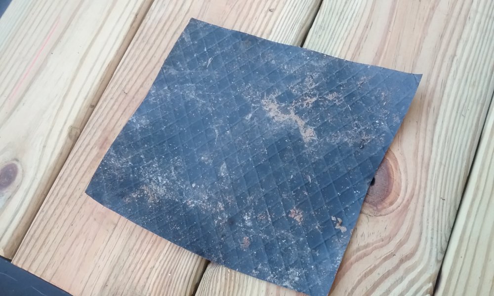

Here is a piece of 12 mil that I cut from my own crawsplace this morning showing the side that has been in contact with with rich earth for the last 10 years. Survived many floods and has withstood door traffic and random storage items drug across it. Unscathed. Can you imagine what a 20mil will do?

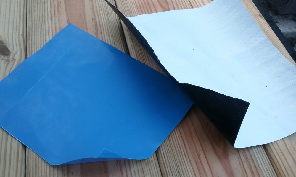

Here's two other examples of what's commonly seen under houses. The blue is a roughly 16mil material originally for brick encapsulant to repel water intrusion on subterranean dwellings. It's not fiber reinforced and tape does not adhere to it as well as with the above. I don't like it. The other is offered by Dry dog barriers. Its....ok.
